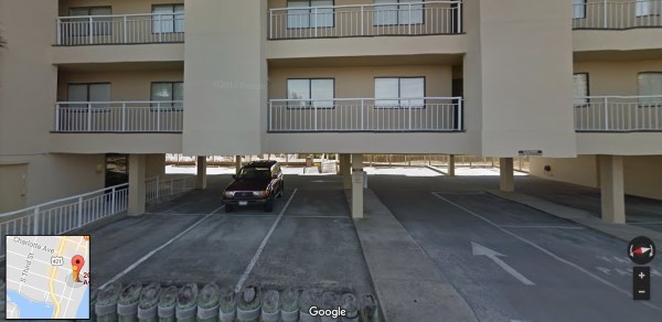

I noticed this comment:
Quote:
"Inspection of newly discovered corrosion to the structural columns has revealed that the structural integrity of the entire southeast corner of the building has been completely compromised. The cross sectional area of the structural columns in question has been reduced to half of its original size and therefore half its intended capacity. The bolted and weld connections at the floor and balcony systems are entirely corroded away."
That isn't really true. If you lose half your section of a column, the buckling load would be reduced by more than half. With thinner flanges, etc. you could have way less than half capacity with localized buckling.

The address, 201 Carolina Beach Ave. South, is (Atlantic Ocean) beachfront property. The corrosion in the photos is typical of long exposure to salt air with occasional submersion in sea water. In the past 30 years, the Carolina Beach part of North Carolina (near Wilmington) has had more it's share of tropical storm / hurricane hits and near misses including associated storm surge to flood parking area under the building with ocean water. MikeHolloran is right, with this type exposure, half the steel may be gone but what remains is really just glorified rust.
After flooding with salt water, architectural covering and coating just accelerate corrosion - year round high humidity together with the salt that remains in the coverings ensure that the steel stays both damp and salty.
