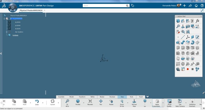

RE: Basic CATIA VBA question
1 In generative shape design I go to Tools > Macros.
2 I create new macro with MS VBA language. Then I hit 'Edit' and paste your code in a window that appears (the same window is shown on image 4).
3 Then I run this macro and get this error message.
4 When I press 'Debug' I can see a line where error is generated.

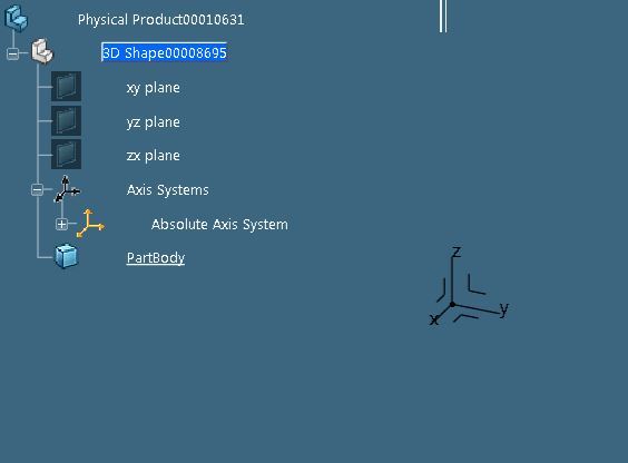

Look at the picture please. When you start to run the macro you need to have already created an axis system, this is how I setup my starting 3D Shape. In 2017x when you want to create a 3D Shape it will be inserted directly under a physical product, that's a difference between 2016 and 2017 if I remember correctly.
Regards
Fernando
https://picasaweb.google.com/102257836106335725208 - Romania
https://picasaweb.google.com/103462806772634246699... - EU
Thank you for showing my error.
Now macro works, but only partially:
It creates a sketch and then stops on this line:
boolean2 = settingRepository1.GetAttr("DisplayRequirementsMode")
Yes, now that sketch was extruded and macro finished without errors.
thank you for your patience.
