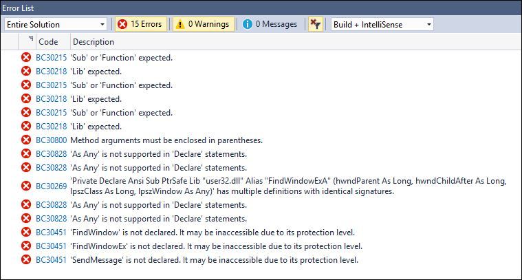

RE: Command "Recognize" and error message
Hi Fedro and Cilici...
I have modified the above code with PtrSafe but still have lots of errors as per pictures below. I have tried to figure out but no success yet. Please help
*** My code in Visual Studio 2017 Community
*** Error list
Your help is much appreciated and have a great day.
Thosnow,
the code works in all aforementioned IDEs but not entirely the same (e.g. 'long' in VS should be 'integer' type, PtrSafe is only if you run VBA on 64bits and so on)
Here are the declarations for VS:
CODE -->
Private Declare Function FindWindow Lib "user32.dll" Alias "FindWindowA" (ByVal lpClassName As String, ByVal lpWindowName As String) As Integer
    Private Declare Function SendMessage Lib "user32.dll" Alias "SendMessageA" (ByVal hwnd As Integer, _
                                                        ByVal wMsg As Integer, ByVal wParam As Integer, _
                                                        ByVal lParam As String) As Integer
    Private Declare Function FindWindowEx Lib "user32" Alias "FindWindowExA" _
                                                (ByVal hWnd1 As Integer, ByVal hWnd2 As Integer, ByVal lpsz1 As Integer, ByVal lpsz2 As String) As Integer
If you can't handle FROM here, you shouldn't use VS.
