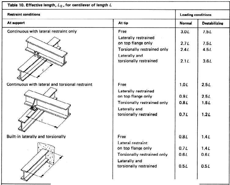

What is the difference between normal and destabilizizng load in BS 5950-1 as per below table.
Can I assume DL, LL and Wind load as Normal loads?
RE: Normal and destabilizizng load
Destabilizing likely relates to a load position above the member shear center rather than the origin of the load.
