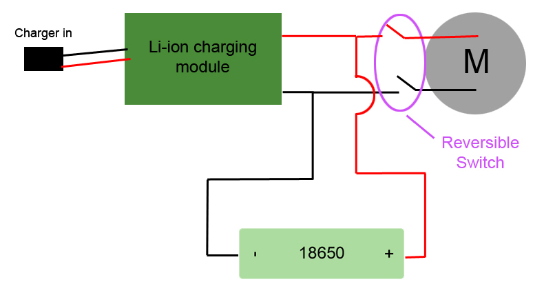

Awesome, thanks so much for the help. A power screwdriver arrived on my doorstep today in fact. After disassembling it, I drew up a diagram with the major components for you to reference. This is a Black & Decker LI2000, if anyone's interested.
Aside from a li-ion charge protection module, the circuit consists of a single 18650 cell hardwired directly to a 3.6v motor through a reversible switch (for forward/backward screwdriving). The motor output is sent through an 8:1 planetary reduction gearbox. The screwdriver offers exactly the sort of use characteristics I want, minus the fact that the motor/gearbox/battery are too large for the device I'm designing.
Considering my first circuit was nearly identical, it would seem that the solution lies with some combination of the power source, motor, and gearbox. Can someone confirm/refute my thinking:
My first guess is my original power source lacked sufficient capacity or discharge capability. My first prototype consisted of four AAAs in series giving 6V, but that's only 750mAh when fully charged. I would bet a pretty penny that the 18650 has significantly better capacity and/or a higher discharge rate. I had that connected to a 6V motor that claims 260rpm through a gearbox. I'm not positive what the gear reduction on that is, but I think it's in the 45:1 range.
Another guess would be that the my original motor was too much of a high-speed/low-torque sort of number. Though one would think that the 45:1 gearbox would take care of that issue. I'm putting my money on my first guess.
Let's assume that I'm stuck with a 6V motor (3V gearbox motors of sufficient size are hard to find). For my quick 'n dirty prototype, does it sound reasonable to put two 14500 li-ion cells of decent capacity (1200mAh, for example) with built-in protection in series and simply run them through the switch and into the motor? That should be reasonably safe for something that only has to work for a few minutes at a product pitch, shouldn't it?
RE: Designing a handheld, battery powered device. Need advice on minimizing motor slowing under load.
A quick tutorial on brushed DC motors.
Most small brushed DC motors have a permanent magnet field and that is what this tutorial addresses.
First, lets look at generation:
A brushed Permanent Magnet motor will act as a generator whenever it is turning.
The voltage will be closely proportional to the speed. For simplicity we will assume the voltage is directly proportional to the speed. The errors will be quite small.
Let's state that our example motor generates 10 Volts when it is turning at 1000 RPM.
Now let's look at motor action.
Now we apply 10 Volts to the motor. The motor runs at 950 RPM with 10 Volts applied.
But because it is turning it is also generating. At 950 RPM it will generate 9.5 Volts.
When we are discussing motors the generated voltage is called the back EMF.
With 10 Volts applied and a back EMF of 9.5 Volts we will have 10V - 9.5V or 0.5 volts to drive the current through the resistance of the armature circuit.
Now start to load up the motor. The motor will slow down.
Let's load it up until the speed drops to 900 RPM. Now the back EMF is 9 Volts and we have 1 Volt driving the current through the armature circuit.
At 800 RPM the back EMF will be 8 Volts and we will have 2 Volts driving the current.
Now this is a motor connected directly to a stable voltage source with no speed controls whatever. This illustrates the basic action of the motor and the effect of slowing speed on the back EMF and on the current.
Speed regulation:
The lower the resistance of the armature circuit the higher the no load speed of the motor and the better the speed regulation.
Let's change the motor specs. Now our motor runs at 990 RPM with no load. The back EMF is now 9.9 Volts.
The load that originally slowed the motor to 800 RPM will now slow the motor to about 960 RPM.
The lower the resistance of the armature circuit, the less the motor speed will drop under a given load.
Voltage:
Small brushed PM motors are quite forgiving of voltage. Mostly.
Take our original motor rated at 10 Volts and 1000 RPM. Apply 7.5 Volts and it will turn at 750 RPM.
Apply 15 Volts and it will turn at 1500 RPM.
What is the downside of over voltage?
Starting current.
When the motor is started the back EMF is zero and the full applied voltage acts to drive current through the armature circuit.
150% applied voltage means 150% starting current and 150% starting torque. Sometimes an issue, sometimes not an issue.
Speed.
If the speed is increased too much, centrifugal force may throw the armature apart.
Load.
If a motor is being evaluated for a given load at a given increased speed the load should not be an issue.
If a motor is coupled to an existing load and the speed is increased, load on the motor may increase dramatically. This is especially true of fans and centrifugal pumps.
A suggestion.
Decide how much you want to discharge your batteries.
As an example, you may want to limit 7.4 Volt batteries to 6.4 Volts.
Use a 6 Volt motor and you will have 0.4 Volts safety margin. PWM your battery voltage to 6 Volts.
This is an example for illustration. Keith is better able than I to suggest recommended voltages.
But, in the event that you can't make a 6 volt motor work, don't despair, plan on running your 6 Volt motor with 5 Volts and select the appropriate gear ratio to get the wanted final speed.
Depending on your load characteristics you may not need a speed regulation circuit.
