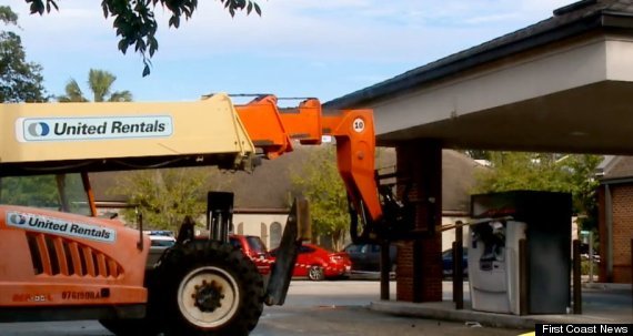

I have been tasked with designing a foundation for an ATM machine. Where the ATM is located at, I have 1500 psf max allowable soil bearing at 2 ft below grade. I plan on making the foundation at least 2 ft thick from grade. I am basing the design of my foundation off of a Dash 2000 ATM pad with canopy. How much the mat should extend above grade? I was thinking of just calling out 6 inches above grade. Do I need to determine the base flood elevation or is there something else I have not considered? All suggestions/comments are appreciated.

Are there any security concerns that would affect the anchorage of the ATM to the foundation? Say, having anchor bolts embedded deep enough to minimize the chance of someone connecting a powerful truck to the ATM and pulling it off the foundation then dragging it away in the middle of the night. Have heard of this sort of crime happening.
