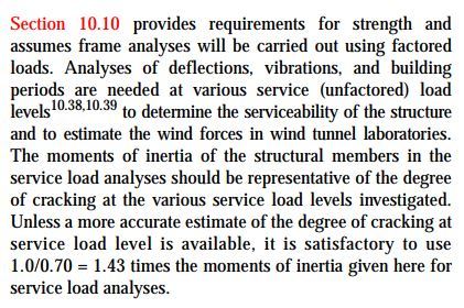

I think we should make a further distinction between a service level analysis and a strength level analysis. In the Commentary of Section 10.10.4.1 of ACI 318-11, it states the following:
So a service level analysis which is used to determine deflections, drift, periods, etc. can utilize 1.43 times the cracked moment of inertia.
For a building analysis, this may mean that if you are using a software program like RAM SS or Etabs, you should make two models: one for serviceability using 1.43 times cracked factors and one for design without the 1.43 factor.

It's very possible that I'm misinterpreting something (please let me know if I am) but,
Celt83: If you are performing a strength design of a concrete structure using a program, you'd create load cases using the ultimate wind and seismic loads and modify the various structural members using the crack factors from 10.10.4. But if you are analyzing the serviceability of a concrete structure (drift, period, etc.) you'd create serviceability load cases using the lower wind speeds in the ASCE 7-10 commentary along with including the 1.43 multiplier to the crack factors. With this methodology, do you think the applied loads would be inaccurate?
JAE: Even setting up service load combinations (to check serviceability) you'd still need to use the 1.43 multiplier to the crack factors.
If the above is accurate, then I don't see how it's possible to create a single analysis model to design for strength and serviceability of a concrete structure if serviceability design per 10.10.4 enables one to increase the crack factors by 1.43 and strength design does not, since these would be modifiers to each structural member.

I believe the 1.43 factor is only used to "up-facctor" the reduced moments of inertia "given here".
If you start with service loads (unfactored) and then check for cracking and derive Ie values accordingly, you don't have to go through the steps of downgrading, then upgrading (1.43) the moments of inertia.

dcStrucEng,
I think you can do what you (and 10.10) suggest:
1. Set up a model and adjust the moments of inertia down per 10.10.4.1 (ACI 318-11) and analyze using factored load combinations. Design for strength.
2. Take your same model, but then adjust your moments of inertia back up by 1.43. Then use unfactored combinations to check for serviceability criteria.
3. So in essence you do have two different models - one with reduced stiffnesses for strength design and one with less reduced or non-reduced stiffnesses for serviceability design.
Alternatively:
2. Take your same model and remove the stiffness reductions.
3. Run the model with full uncracked stiffnesses using unfactored load combinations.
4. Investigate members (columns and beams) and if cracked, modify the stiffnesses per 10.10.3 (ACI 318-11) which is essentially similar to deriving Ie values including axial effects per 9.5.2.3.
5. The investigation of each member would require possibly cracking only portions of the member along its length as some portions crack and other don't.
6. Step 4 above is iterated as the members sequentially crack further until the model analysis converges.
Granted, the second option is much more work and...why would you? Unless there is some unique features in the model where the global reductions per 10.10.4.1 might not be accurate.
