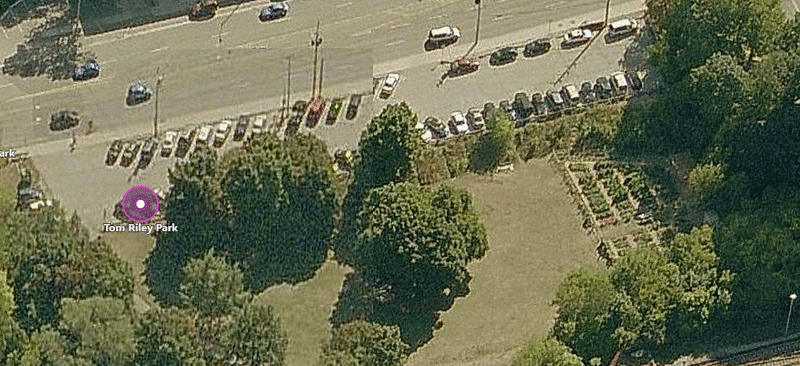

Here's a slightly better view from Bing Maps. It likes from this vantage point there there are multiple ruts in the vegetation where people have taken a shortcut to get to the garden, presumably.

is the garden people want to visit the area on the right side (per caption)?
RE: City working on replacing Etobicoke man's homemade stairs at park
I assume so, otherwise, there wouldn't be a shortcutting of about 480 ft, one-way, to get to the access point on the left side of that image to the edge of the garden.

Looks like a good example of urban designers ignoring desire paths.

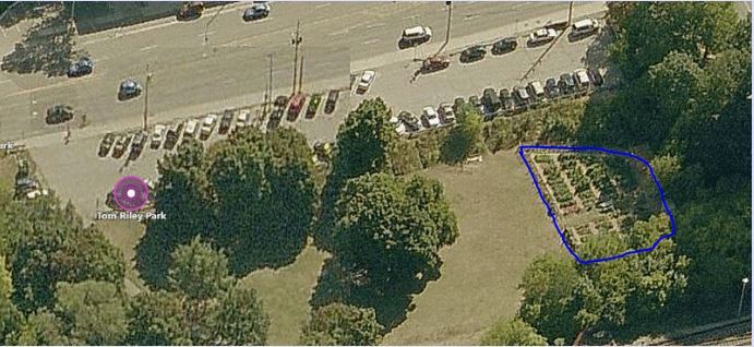

Have blue marked on the picture what looks to be an access point (or possibly not)? Any clue?

I don't think your last photo is relevant. Your first one shows the area of a joint community garden, where folks grow some vegetables. There is a gradually graded access point on the left side of that photo, but it is the long way around. So naturally, some of the garden users found a more convenient, albeit a bit dangerous, way of getting down to their patch. Now they are getting a proper stair.

The intended access point seems to be at the far end of the parking lot from the garden where the paved path goes. The well-worn path is at the garden after hopping over the parking lot guard rail.

I'm not even sure what you are trying to do. The shortcut is from the parking lot at the bottom right of image to the garden, just above the parking lot, which is downhill from the parking lot. The long way to the garden is to walk to the extreme right of the parking lot and walk all the way back on the grass to the garden. All the paths you've drawn are seemingly irrelevant to the problem at hand.

That garden looks like a set of allotment plots. Gardeners go there, park, and then trundle down the hill to weed and water their veggies. The stairs were likely a big help, but of course anything on city property has to be "safe", even if it makes an unsafe condition which is clearly being used frequently by the public, safer than it was.
