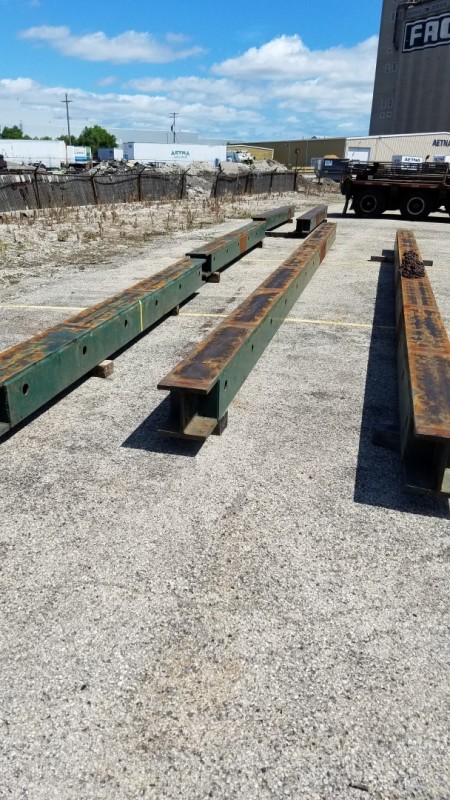

Ours is essentially 2 rails made from heavy I-beams. Each beam has a yoke with holes that pins go into, the pins go through the web and reinforcing plates of the beam to push against, and then cap channels ride on top of the beams with the load on top of them. Mounting points connect the yokes to the cap channels via large hydraulic cylinders. When activated they push or pull the cap channels along. The sliders are, with extensions, 18'6" long and have a 6" contact surface with the beam (roughly) so I'm figuring 110 psi at best case with 100 ton on it, sometimes they only fit in 8' of the slider however at which case we're looking more at 350 psi. The unit itself moves very slow, the rate of travel over the plastic is only maybe 2'- 2.5' a minute.

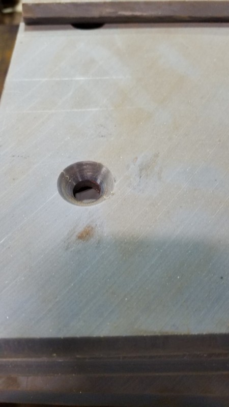

So we decided to hire a plastics company to choose the proper plastic for us so we could line the top of the beams. I don't have any paperwork as this was a few years ago, and the plastics company has since went out of business, but we finally got the system downed long enough to switch over to the mounted plastic. The plastic is grey, supposedly has lubricants embedded into it, and seems to be very dense, but I was told it was not UHMW as that was brought up in a meeting and they suggested this instead. Based on that I have no clue what it is. They said it was used as turntable wear pads for heavy equipment like draglines but I find that hard to believe given how hard it's moving for us.
What I do know is that when we started doing a test slide with only 50,000 lbs, the whole system began to chatter wildly. The test load was bouncing slightly. I also know that if the plastic gets wet, instead of becoming slippery it turns more into a tacky surface. We tried lubricating the surface with silicone spray as that's "less messy" in the customers view, but it had no effect.

Does your gray plastic have a mottled, silvery appearance? Might be MDS-filled nylon. Spraying graphite or MDS spray on the rails might help keep stiction down, but I'm not a fan of the stuff.

This is a closeup of the plastic.

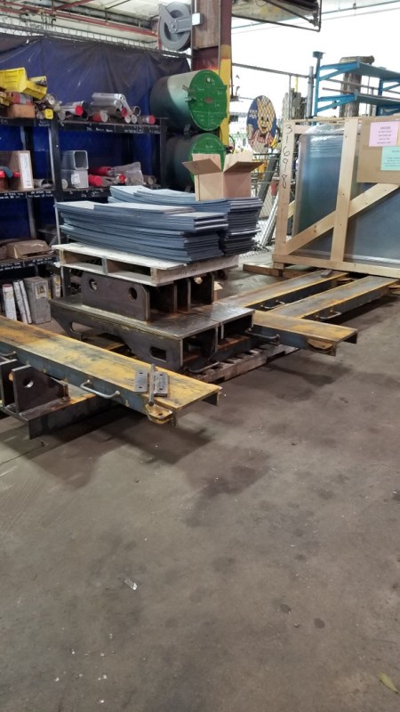

This is the plastic stacked above the parts that actually slide on the plastic.
These are a small assortment of the beams that the plastic gets bolted too.

Man, sure seems like roller bearings or recessed wheels are the way to go here. Certainly no thicker than the plastic already being added, if done correctly.

Might seem that way, but once you see how the jobsites are and how fast those would get dicked up with debris just from the airspaces you'd see that's a bad idea. The nice part of sliding is that its surface to surface so there's not any room for anything larger than a flake of rust to really get under the kit. With rollers we'd have to worry about gravel, mud, cement, and other stuff. These are used in some pretty messy job sites outdoors.
