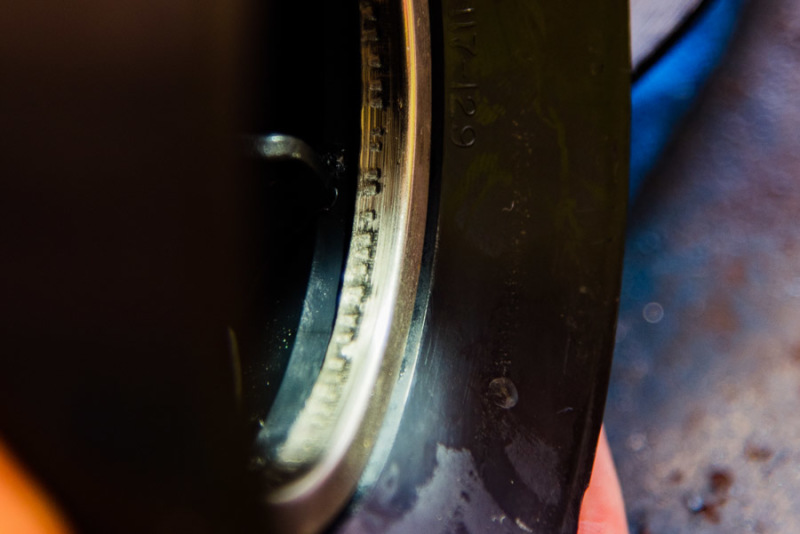

Currently in the midst of an investigation into the failure of a high pressure booster pump. Today I was finally able to eyes on broken impellers. The pump is scheduled to deliver filtered sea water into RO membranes pressure vessels.
Pump details:
Energy Recovery Inc.
Model: HP-2403
3 stage centrifugal
300 GPM @50 psi
Boosting from 700 psi to 750 psi.
20 HP
We have had multiple failures in 4 pumps. Failures are occuring 2-3 weeks after startup.
Markings on the destroyed impellers along with testimony that VFDs are ramping up speed or hunting within hours of failure lead me to believe failure is due to contact between the impellers and housing. Tomorrow we are going to investigate further why this contact is occuring.
Now to the thread title and reason for this thread; per pump specification and submittal data the impellers are made of Noryl. Googling Noryl, I find evidence that this material can "absorb" water. Is this right? When used for a pump's impeller, does material expansion need to be considered as a possibility in these failures?
I've also notice white discoloration. I'm not completely convinced the discoloration is due to rubbing or a result of chemical interaction. What, if any chemicals can have an impact on the properties of Noryl plastic? Or just cause some discoloration?
Gonna keep searching Google results, there is just so much information out there finding what I am looking for is like finding a needle in a hay stack. If someone here can help me narrow my search, I would appreciate it.
Attached photos are of multiple failed impellers, when more than one piece is in a photo, there is no guarntee or promise that the pieces are from the same impeller.

Is there wear on the inlet end of all of the impellers?
Is this a clearance or thrust issue maybe?
It looks like the shroud was rubbing.
Plastic impellers expand a lot more than metal does, so clearances need to be adjusted accordingly.

RE: Noryl Impeller in high pressure pump failure
Quote (EdStainless)
Within an individual pump, no. This and the manner in which the impellers are broken are lead me to a single conclusion of "how" they are failing. Another observation I have made is that the top "cover" of the impeller is welded onto the blades and is a weak point in the impeller. Thus my conclusion for how they are failing is this: the outer ring of the inlet of the impeller is binding and is then torqued/twisted off the blades. With the shaft and blade turning at 3750 rpm (I need to double check this for you) and now a loose piece in there, it just tears itself apart.
I've been contemplating this question myself. I have not been able to rule these issues out as the cause yet.
If it is a thrust issue I would expect to see more damage on the top of the cover plate. At least more consistent circular scarring. The marks I have seen look to be more from post failure while the cover is banging around inside the housing from contact with the blades.

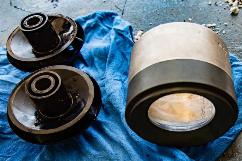

Some more pictures:
Intact impellers and housing at first stage. Impellers fit in the housing from the top of the photo and water inlet is from the bottom. Grey cover plate on end is PVC per submittal sheet. Tubular shroud is metal.

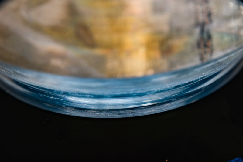

Closeup of PVC first stage housing cap. Photo edited to enhance marring resulting in the PVC looking black, in reality it is grey.
Close up of 2nd or 3rd stage housing showing evidence of contact with the impeller. Outer ring of impeller cap fits inside metal ring of this housing piece. This housing piece contain guide vanes directing water from previous stage into inlet of the next stage; except for the metal ring (crimped on), the piece is Noryl plastic, same as the impellers.

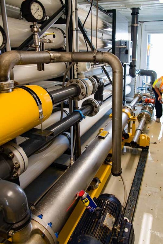

View of the RO membranes and piping. Booster pump that is failing is at the very bottom (WD-40 can is on the motor), impeller section has been removed for inspection. WD-40 can is leaning against the impeller section of the primary high pressure pump (motor is just of photo to left). Yellow device on left is the energy recovery device (Pressure Exchanger). Feed flows into the end of the recovery device, then out the top and down to booster pump.
The Energy recovery device/pressure exchanger. There are 2 flows through this device, on the right is the feed water, goes in on the end, out the top at ~750 psi. As you can see in the previous image, there are no gauges to validate pressure or flow between the recovery device and the booster pump. On the left side of the recovery device is the concentrate flow; water from the membranes that is not processed comes in on the top left, and exits out the left end.
