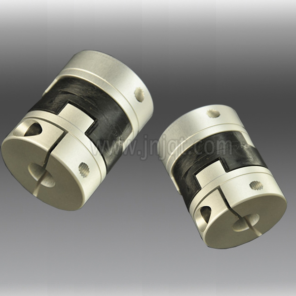

An Oldham style coupling could work, you can easily find different materials such as plastic or rubber for the central floating portion. As btrueblood mentioned you will need to define your size and torque requirements for us to give you more than general options.

Thanks for all the suggestions. I am going to try the isolated coupling. Rubber has a pretty low heat conductivity so I am thinking this will do nicely.
