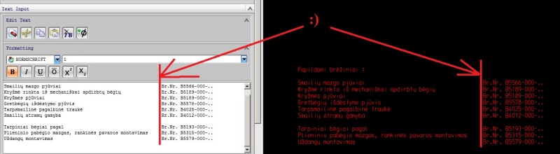

Hello all,
just upgraded from NX8 to NX10.
Please take a look at the attached picture. Something wrong with fonts in text editor. Is it possible to change it to smth else, to avoid incorrect alignment?
We have lots of drawings with such annotations (old drawings), and it is quite messy to edit them. There were no any problem with NX8. It seems that NX8 used different own font in editor dialog.
Thanks.
NX10.0.3.5 mp16, win7 64bit

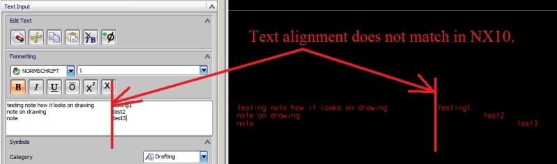

It appears that the font that you're using is what is often called mono-spaced, meaning that all characters are the same width, while the font used by the text editor is proportionally spaced. The real issue is that the text editor does NOT provide an actual 'preview' of what the note will look like but rather only what it says. In other words, the NX text editor is NOT a WYSIWYG style editor, that is it does not provide the user with a "What You See Is What You Get" preview.

I understand what you are saying, but as I said in my first post, when I tested in NX8 and NX10 (using different fonts to you) I was not seeing the alignment as you say you got in NX8.
Only when I use the normschrift font you supplied can I see the same behaviour in NX8 (which NX10 doesn't do).

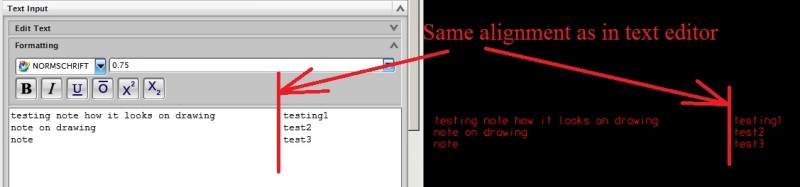

RE: Text alignment in editor
The issue is that alignment does not match in text editor and as it looks on drawing.
So how it looks in NX8:

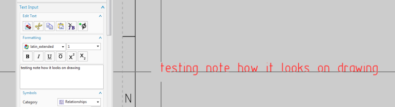

@cowski, you've nailed it, that's why the difference between NX8 & NX10.
NX8 is probably set to the default - NX(Recommended) whereas NX10 has been set away from the default to most likely 'Classic with System Font'.
The last two images show that the fonts between versions in the text editor are different.
