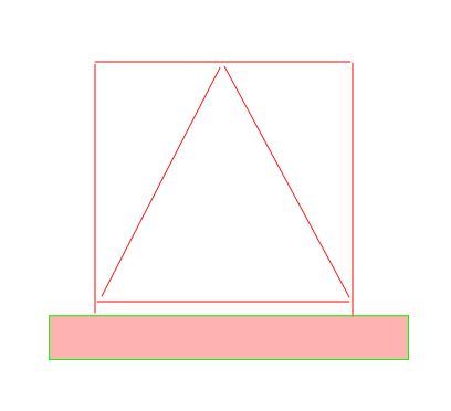

One of my first projects out of the gate was one of these. I didn't clue into the base connection issues until it was almost time to issue. Good times. Here's what I'd recommend:
1) Use a product like the Fabreeka stuff that has published coefficient of friction values that you can have confidence in.
2) Rely on friction across the thermal pads to deal with your shear.
3) Make sure that the friction you need is available when the shear is present. That can be tough for braces that don't pick up much gravity load. One strategy is to use chevron bracing and include a drag beam just above the thermal pads. That way, you're always dealing with your shear at the base plate that's naturally in compression. Another possibility is to prestress your anchor bolts. I always hate to do that other than in a belt and suspenders kind of way or for fatigue. Quality control procedures on that still mystify me as does accounting for creep etc.

I'm not quite sure I follow your comment suggesting that the shear is taken out by the compression column of the braced frame. The shear is applied at the uplift column. How does it get to the compression column in order to engage the friction of the Fabreeka thermal block?

Quote (mbenjami1)
Quote (KootK)
RE: Steel columns sitting on thermal blocks at braced bays
Ah, I'm with you now. Thanks!
No sweat. It's an extra member and can't go where traffic needs to pass though but it's a decent system. In many instances, I'd expect the member to be considerably cheaper than fancy shear connection voodoo at the base.
