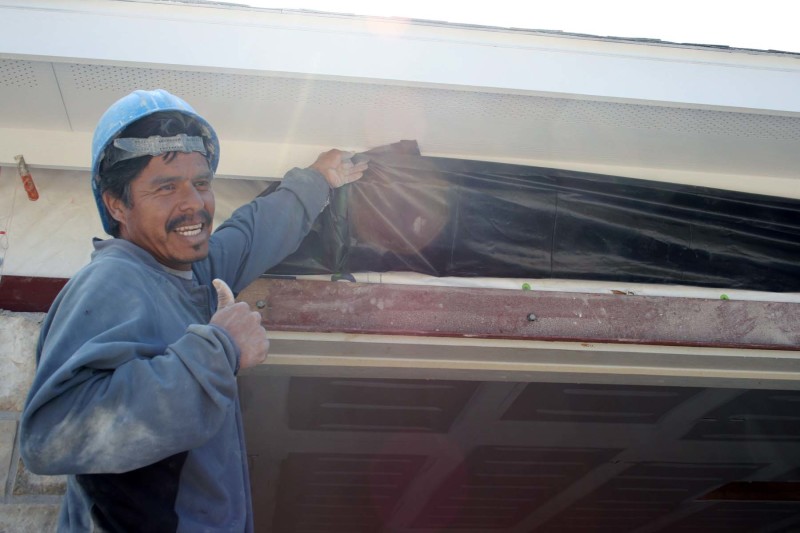

On current brick facades in Texas, the longer span lintels usually get bolted to the wood frame header. Typically you see this at 2-car garage door openings where you have a 16ft-18ft spans. I believe the common practice is 1/2" lags with a 2ft spacing. I have also seen bolted lintels on spans above sliding doors if they were more than 6ft.
Although I have never seen an engineering analysis on it, I think the bolts allow enough load to shift off the lintel to prevent significant deflection and subsequent cracking. In my pre-engineering days, I worked for a large Texas homebuilder. Unbolted lintels above garages were a common warranty item and a real pain to fix because you had to tear out the brick to fix. Usually you then ran into color matching issues with the homeowner, which was a losing battle.
Anyway, I doubt the lintels were bolted on a 50 year old house, so that could be contributor to the cracking problem on the subject property. Personally my thought on the subject property is that there is some expansion and contraction going on combined with some seasonal slab/support movement.
Here's a photo from a house I built a few years ago. I don't know who the mason is, but he's proud of the bolted lintel! You can also see the poly they put down as a bond break in the photo too. :)
