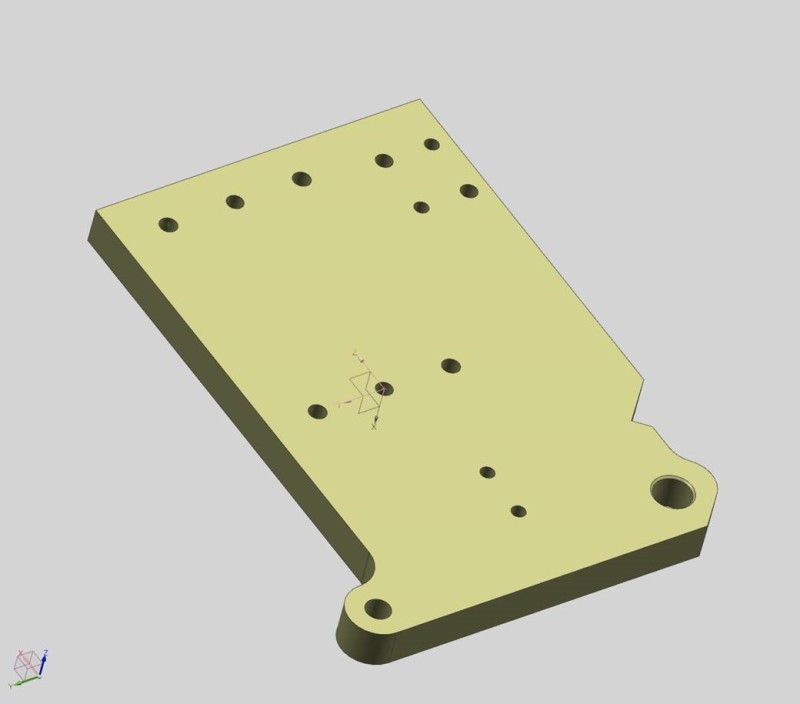

Hello Everyone,
I have created a Local Co-ordinate System (LCS) in the Work part / Displayed part, on one of the Hole Center points. I need to get all the other hole center points (X,Y,Z) data with respect to this newly created Co-ordinate System.
Please refer to the image below.
How can I convert the point (X,Y,Z) values to the new co-ordinate system ?
I tried using both these function but it is not working, as it does not take as input the LCS that I have created in the part.

I see at least 3 options here:
  • Temporarily move the WCS to the datum csys and use the Abs2WCS function that you already have.
  • Compute the new point location by using MapPosition in conjunction with CreateCsysMappingMatrix.
  • Use some linear algebra and create your own mapping functions.

Move the WCS to the LCS and try this :
CODE --> NX
Dim WcsIni(2) As Double
        Dim pt_ini(2) As Double
        pt_ini(0) = 0
        pt_ini(1) = 0
        pt_ini(2) = 0
        theUfSession.Csys.MapPoint(UFConstants.UF_CSYS_ROOT_COORDS, pt_ini, UFConstants.UF_CSYS_ROOT_WCS_COORDS, WcsIni)
        Dim pt1(2), pt2(2) As Double
        pt1(0) = inPt.X
        pt1(1) = inPt.Y
        pt1(2) = inPt.Z
        Dim WcsPt(2) As Double
        theUfSession.Csys.MapPoint(UFConstants.UF_CSYS_ROOT_COORDS, pt1, UFConstants.UF_CSYS_ROOT_WCS_COORDS, WcsPt)
        Dim Pt_final(2) As Double
        Pt_final(0)=WcsPt(0)-WcsIni(0)
        Pt_final(1)=WcsPt(1)-WcsIni(1)
        Pt_final(2)=WcsPt(2)-WcsIni(2)

Suppose your local csys has origin Q, it's x-axis is U, and it's y-axis is V.
Then, given a point Q, its coordinates wrt to your local csys are:
x = (P - Q) * U
y = (P - Q) * V
Here "*" denotes a dot product of vectors.
The vector arithmetic is easy using SNAP functions. Somewhat clunkier using NX/Open.
RE: Convert and report 3d points in local co-ordinate system using NXOpen ?
Or use the .MapPosition method and let the API do all the arithmetic for you.
