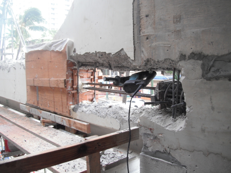

A recent live-termination that I was involved, with 5 bundled/grouped tendons, the distance between points A and B was about 30 feet - so we chipped a few feet at A and at B and left about 22 feet of concrete remaining between A and B (to 'confine' a severed tendon) and also stripped back the sheath and de-greased the strand at the opening side of A and B and formed a temporary anchorage via an epoxy-bond anchor. We cut the strand behind the ram near A, with an elastic shortening length was only about 3 feet, and then cut the strand behind the ram at B (also with an elastic shortening length of about 3 feet), resulting in less shock loading to the rams, and the cured epoxy 'restrained' the others end of the strand, than if we had to deal with 20+ feet of free-release length.
The following photo shows the 5 tendons, with RHS that remains, and the LHS to be demoed. The timber forms on the LHS is where the temporary epoxy-bond plug was used to 'control' sudden release over 20+ feet.
In this instance we did not have access to the dead and live-end anchorgaes, and no shoring was able to the installed either, so we had to do 'live-terminations'.

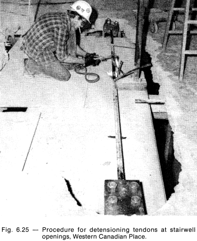

PTI is pretty silent on openings. The 5th edition of the PTI Manual on page 375 has this photo of a pair of tendons being heated to de-stress the strands - NOTE the large bolted plates to reduce the withdrawal of the strands.

The project I posted the photo above was in Hawaii in late 2015. There was a contractor and engineer on the project (a retrofit of a late 70's building), and the contractor's sub for rebar and PT had no idea how to do the PT 'live-terminations' (or PT generally, IMO), and the EOR and I had worked on past projects together for many years so I was engaged by the owner/contractor/engineer team to provide a methodology along with sketches, step-by-step procedures, materials etc. All came together well - no safety concerns, time efficient, but the sub tried to 'ream' the GC and owner on cost - trying to cost-out his lack of experience with PT as a reason to inflate his costs - submitted a change order of $50K for 5 tendons! - one of the reasons why such work needs to be carefully documented and coordinated.
