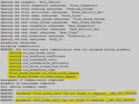

Hello gentlemen,
Adams Car 2014 :
Since a couple of days I struggle to find out how to modify the _MDI_SDI_Testrig file, I mean to add or remove communicators (cis / cos / cil[r] / col[r] ) or parameters variable (pvs / pvl[r]).
For exemple I splitted the template _brake_system_4Wdisk.tpl in two : _front_brake_system.tpl and _rear_brake_system.tpl and also I created two new subsystem files. But when I try to open the entire assembly I receive the errors from the picture below.
I think in order to avoid these errors I need to update the testrig file, but where can I find it ?
Please help me with some hints. Thank you for you time.
