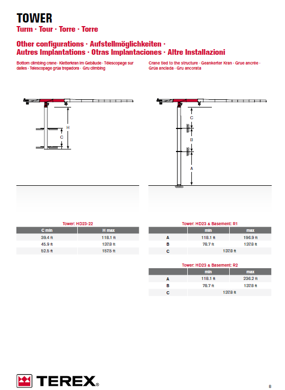

I am new to doing peer review on tower cranes. The tower crane stands 260ft tall with a massive foundation. I see the designer has used crane dead load & weight of crane footing in arriving at reactions and overturning moment. In my opinion wind loads should be included to obtain base reactions, i could be wrong. Please share your valuable input.. If i am supposed to check for wind loads what would be a quick way to get the reactions without having to do the entire calculations myself, because this is only peer review. I just want to get a feel for structural capacity of footing with wind loads on tower crane.

Is the crane braced at floor levels? Moment will be eliminated. Can you ask the designer how it was designed?
Dik
RE: Tower crane peer review
No its free standing for height of 260ft.
No I don't believe that it is free standing.

Chicopee, am not sure about the free standing height. Crane used is Terex CTT 561A-20, i do not see the specs calling out max unbraced free standing height but i did google it and found out through biggie cranes and rigging company's website mentioned as 344ft (Max. freestanding hook height). Again, i do not see bracing any where on the drawings provided to me.
http://www.biggetowercrane.com/tower_crane_charts....

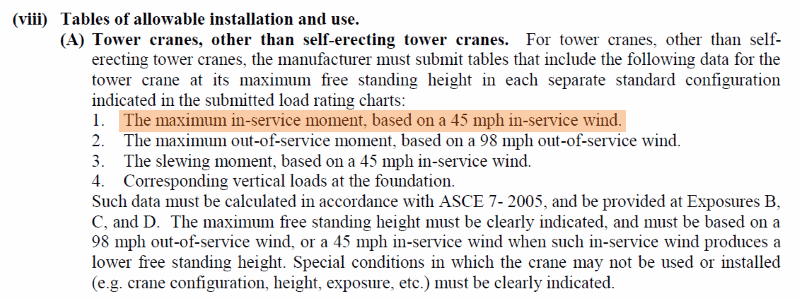

Dik - I have seen interpretations of the 45 MPH as the gust speed; so steady wind speed is lower in that case. New York City has addressed tower crane wind loads with their own regulations. Here is an excerpt:

Dik, thanks for sharing that piece of information. I did go through the crane spec in detail and found out that the spec provides base reactions for In-Service and Out-Of-Service conditions and also specifies that wind loads for out of service condition has been taken from FEM 1004.
Yet to read thru FEM 1004 to find out what wind loads have been used in arriving at the base reactions.

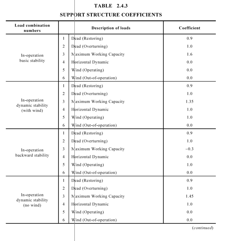

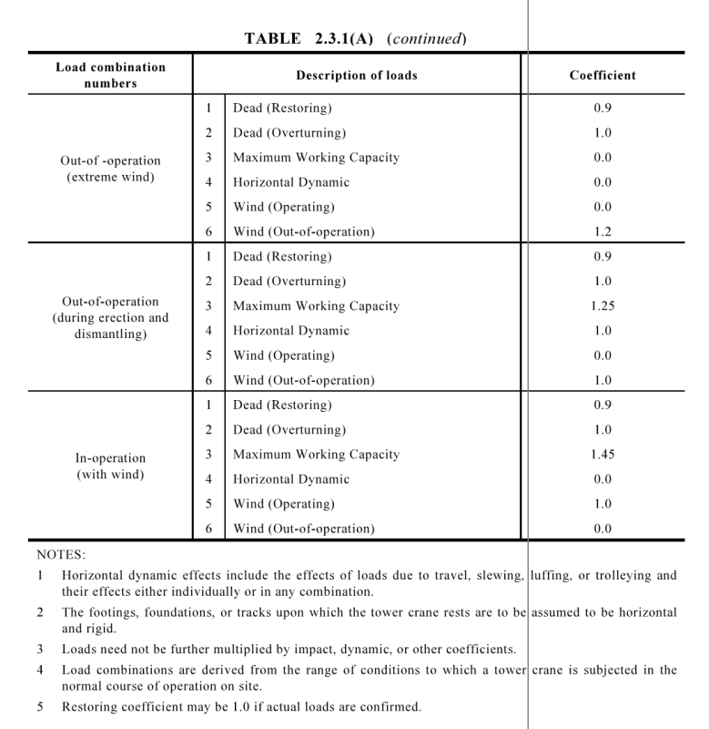

My experience is that for hammerhead cranes the wind load cases are typically more critical than the maximum in service loading (i.e. lifting something in simple terms). For a luffing crane typically its the lifting stuff that is more critical than wind loading as there is less counterbalancing going on (hammerhead cranes I have dealt with have moving counterweight on the back span vs fixed counterweight on a luffing crane).
Not sure where you are but in NZ/Australia we have a code (AS 1418) that outlines all the load combinations that a tower crane foundation must be designer for, there are about 7 load combinations to consider all with varying load allowances. I'm sure where ever you are based there is a similar code with similar load cases.
The thing is usually you have no idea what the loads the manufacturer gives you are based on. They can give you specific loads for specific loadcase, but usually you pay for their engineering team to look at it.
See below for example
SM89,
The "TOWER" schematic you posted gives requirements for bracing the crane to the building (A, B, C).

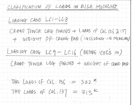

Agent666, i live in US. The crane supplier has provided me overturning moment, vertical and horizontal loads for in-service and out-of-service conditions. But there is no break down on the factors or coefficients used to arrive at those values (Although they mentioned in a footnote that wind loads have been considered for design). I did go through their foundation calculations, apparently the footing has huge uplift force and the designer has used piles to resist uplift tension. Anyway designer has not used 1.5 safety factor on moment so i am gonna have to ask them to redo their calculations including the safety factor for over turning and provide detailed break down on the moments and laods published on their drawings.
