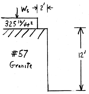

CSFlanagan - I like your 15" thick wall; don't think it will need any "help" from the slab. In fact, capping and tying to wall to the slab may create other "problems"... will get back to that in a minute. Do a agree with dniv and JoelTXCive that a second rebar mat in the wall is a good idea. So much for my opinions, here are my numbers:
#57 Granite @ 103 lb/ft3. Since it will be "consolidated" with a small vibratory compactor, used 115 lb/ft3.
#57 Granite, Angle or Repose: Have seen values from 35o to 45o. Used 40o.
Horizontal Equivalent Liquid (EL) Pressure = 25 lb/ft2
The 6" slab (75 lb/ft2) plus the 250 lb/ft2 Live Load create a 325 lb/ft2 surcharge on the #57 Granite backfill.
Surcharge Load (lateral pressure on the wall) = 71 lb/ft2. Actually, this load is probably even a little lower... will get back to that, too.
Below is all of this graphically, more or less drawn to scale. The surcharge load is less than 25% Edit: 50% of backfill load. Yes, it's resultant force is a little higher (6' above the bottom for the surcharge compared to 4' for the backfill), but not much.
Now, for why I believe the surcharge lateral pressure is < 71 lb/ft2. The 6" slab is heavily reinforced (#7 @ 9" oc.) for almost 2'. This "somewhat" cantilevered slab will pickup much of the 325 lf/ft2 surcharge load. Have not done these calcs, but a more accurate loading diagram may be something like this (Note: I know this is over simplified, but retaining wall calcs have so many variables that the whole process is an approximation)
Now back to the 6" slab with 6x6-W2.9xW2.9. That size mesh has 2 each, 0.192" diameter wires per ft. of width (0.058 in2/ft of width).
Consider a #3 rebar (0.375" diameter, 0.11 in2 crossection). The rebar equivalent to the WWF is #3 @ 22" oc. (0.060 in2 / ft of width).
#3 @ 22" oc. (or the specified WWF) won't do much.
IMHO, if the wall tries to move because of the surcharge load, the slab will crack (and move) where it has only the WWF.
Finally, the backfill is good quality and well consolidated, but it varies in thickness (4' to 12'). I would be more concerned with (very slight) differential settlement cracking the slab. Also, 6" thick seems "thin" for an heavily loaded (250 lb/ft2) floor on backfill. I would be more comfortable with, say 8" thick, with a significant rebar mat, and the slab is "floating" (i.e. not attached) inside the walls. Let the 15" thick walls, with 2 rebar mats, deal with the horizontal forces... no help from the slab needed.
Edit: I see now my calcs deviate from your drawing somewhat. For example, wall height is 11' (not 12') above average grade. Also the 6" slab (75 lb/ft2) is part of the (11') backfill, not the surcharge; therefore ps = 54 lb/ft2 (not 71 lb/ft2). Net result: The surcharge is less of a "problem" than I calculated... but will leave the post unchanged, concepts is still the same. If you wonder where I "dredged up" some of this info, let me know.

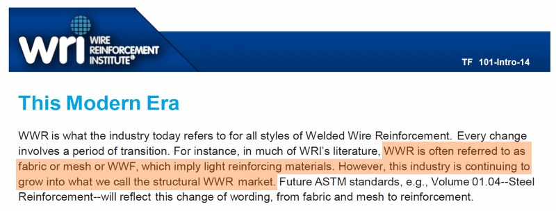

That is a well-worded question. Start with the terminology. Today, Welded Wire Fabric (WWF) can be very different from Welded Wire Reinforcement (WWR).
Part of the problem with WWF is it's flexibility - very hard to get (and keep) it in the correct position in a relatively thin (say 6") slab. During concrete placement, typically the WWF is stepped on, or "mashed" into the subbase at numerous places. Of course it is worthless at the very bottom of the slab. Per your question, if there is enough steel and it is positioned in the right place... yes it will work as intended. With WWF it is hard to get "enough steel" and to have assurance it is positioned correctly. Also, with WWF need to place joints using exactly the same logic needed for plain (unreinforced) concrete.
WWR can be essentially a manufactured mat that should perform equivalent to field-tied rebar of comparable size.
A good resource on both products is the Wire Reinforcement Institute.
For what it's worth, I quit using WWF in the mid-1980's and went with either fibers, rebar, or just an extra 1", or so, of plain concrete - depending on the application. This was for industrial projects where lowest first-cost was not top priority.

SlideRuleEra, thanks for the explanation, makes perfect sense to me. What exactly is the difference though, between WWF and WWR? It seems like the terms are commonly used interchangeably. .
RE: Combination Retaining Wall and Foundation Wall
dniv - That is the type info the Wire Reinforcement Institute provides (link given above). In a "nutshell", WWF is flexible wire welded together, WWR is rigid steel rods welded together (but not without the deformations characteristic to rebar).
See High Strength Welded Wire Reinforcement Compared with Rebar... and
Provisions in ACI 318 for Structural Welded Wire Reinforcement ... and
Manual of Standard Practice--Structural Welded Wire Reinforcement
In general, industry "associations", "institutes", "organizations", etc. are a great source of information (much of it both technical and free). When working with unfamiliar products or materials always search for the appropriate "trade group".
www.SlideRuleEra.net idea
www.VacuumTubeEra.net r2d2
SlideRuleEra, I'm familiar with the product and I've read plenty of WRI's literature, but I'm missing where they differentiate between WWR and WWF, and appear to use the term reinforcement and fabric interchangeablely. If your saying the difference is whether it is a small enough gauge that it can be coiled I get it, but the only explanation I've seen is in the Manual of Standard Practice and it says "Welded wire, sometimes called fabric or mesh is what we refer to today as “STRUCTURAL WELDED WIRE REINFORCEMENT (WWR)” for concrete construction." If Im just being dumb and missing it I apologize, it seems we're really just talking semantics anyway.
dnlv - You are not being dumb... I am underestimating your experience and apologize.
Your mention of wire being small enough to be coiled is a good working definition of WWF - even if it is purchased in flat sheets (easily damaged during concrete placement). I believe confusion comes from the product's history and industry changes over time. The Institute's history publication even hints at that (see the image below).
My subjective interpretation of the term WWF is the problem small gauge products. WWR includes both WWF and the larger rod products which are reasonable substitutes for rebar. Therefore, an Engineer has to proceed carefully - use precise, accurate technical terminology to ensure the correct product will be incorporated into the work.
