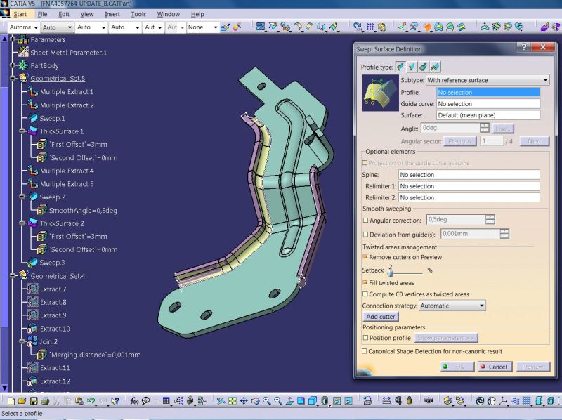

I need to update the bracket (in attachment).
My company doesn't have a Sheet Metal license, so I need to use GSD and Part Design.
My assignment is to create ribs (reinforcements), similar to Rib.2,3 and 4.
As you see, the ribs a created shows what I need, but they are not very well built.
I need to create a create a single Rib ( on the locations of Rib.3 and Rib.4) and another one instead of Rib.2(which in my opinion is not very good, has gaps).
How would you create these Ribs?
