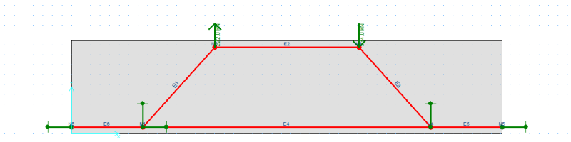

Thanks TME. I'm still struggling with this. I modified my model to include edge nodes with supports, but I still can't get the model to run. Right now I'm at this:
Is this what you mean? If not, could you provide a quick sketch?
RE: Strut and Tie Help
I had to add in another diagonal to your truss to make it all add up correctly. Don't like this arrangement as it's not how the rebar would be laid out but I gotta get back to my own work so I'll have to mess around with this later to get the truss rearranged.

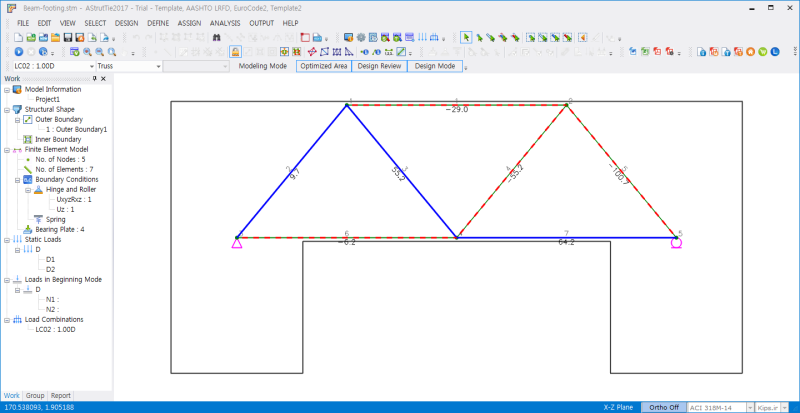

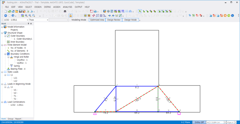

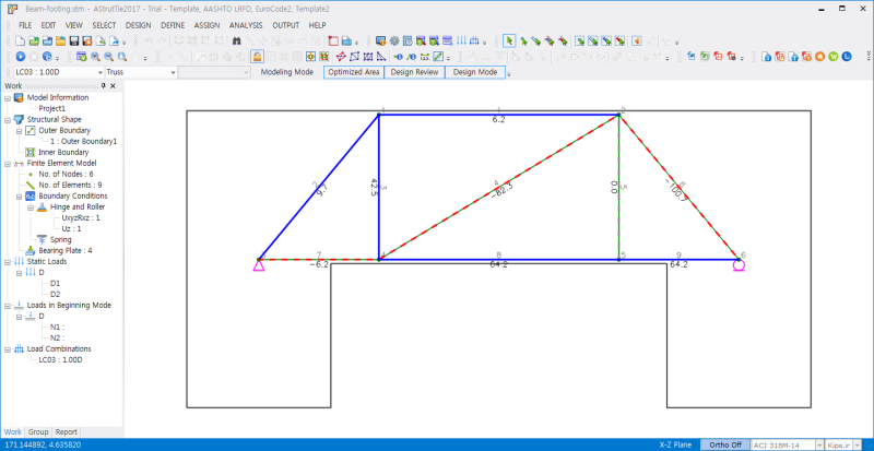

I have created some types of strut tie mdoel.
