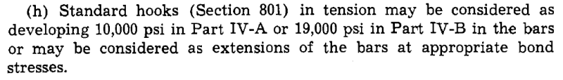

It used to be back in the 60s... If I recall, CSA and ACI allowed 19ksi reduction in the tensile forces for use of a hook.

Batky... this is a bit of a stretch... but, I think there was a 63 edition of the ACI. I think that was the code in effect when I did my thesis on Torsion.

This may be what dik was referring:
Part extract from ACI 318-63:
'Part IV-A' is working stress:
'Part IV-B' is ultimate strength:
You can purchase historical ACI codes from 1908 to 2005 on a USB thumb drive here: Link

Thanks Ingenuity... good guess, since it goes back nearly 50 years... I thought it was the 63 code since that was the only NA code with reference to torsion... and it basically stated that it had to be addressed... no prescriptive formulae. Canadian code had nothing.
