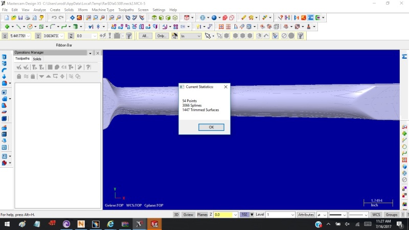

Hi everyone, I tried it all and failed, is it possible to make a solid or surface out of all of the triangle surfaces so I can machine it. All I really need is the radius side of the neck to the foot and head without violating those areas. Just the grey area, except where the surfaces over run the foot and head. Thank you for your time. Rod.

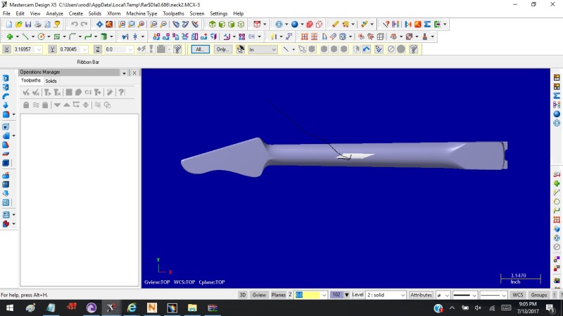

Hi Jim, thank you for trying, I need a solid model to machine the part, without the facets. This is what you sent me.

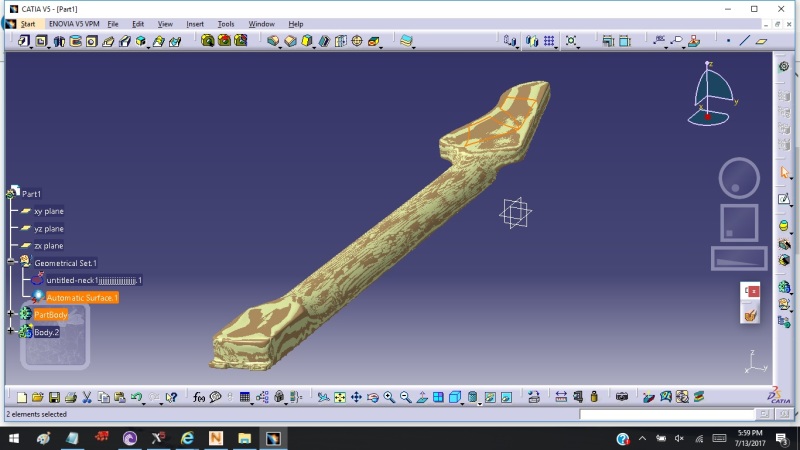

I took Jim's repaired model, put auto surface on it, added closed surface in Catia, but still have all the facets, see orange on the head. Any help would be great.

Thank you very much for trying, it is still full of facets that show when you drag the mouse over it.

Facet or surface spline? I.e. are the edges tangent?
RE: Reverse engineer a scanned 3d guitar neck stl file

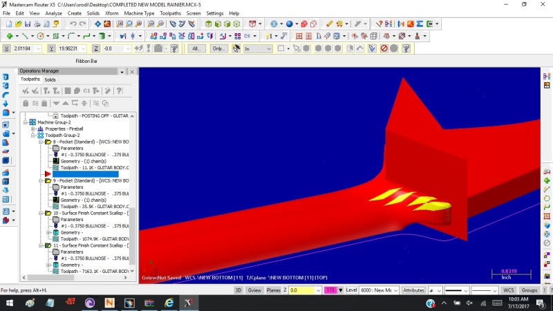

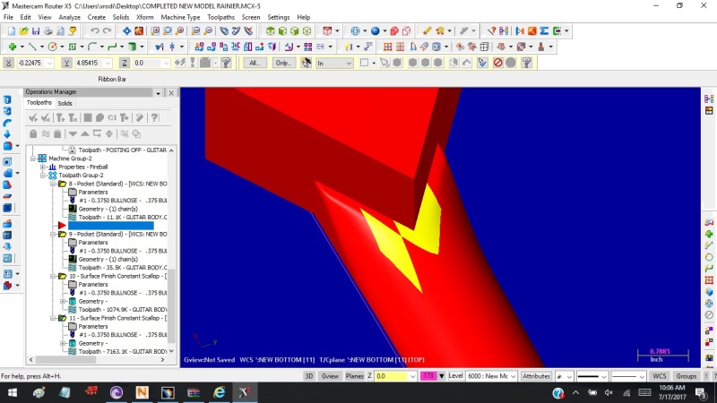

It is all faceted surfaces, that I can't trim to the area I don't want to cut on the head and foot of the neck. I tried building blocks for the cutter to stay away from as shown below but still overlaps the heel and head.
