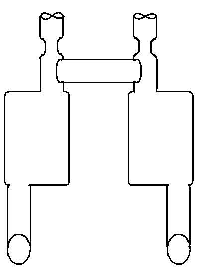

Here's what we tried with the side branch resonator:
I assume some of the trouble getting it to work right is we had to put bends in place to package it under the car. One of my theories is that the bends scatter some sound waves back and not all reach the end and the path for them to get back into the exhaust is not perfectly straight either. We'll see.

have you considered an equilizing tube.
