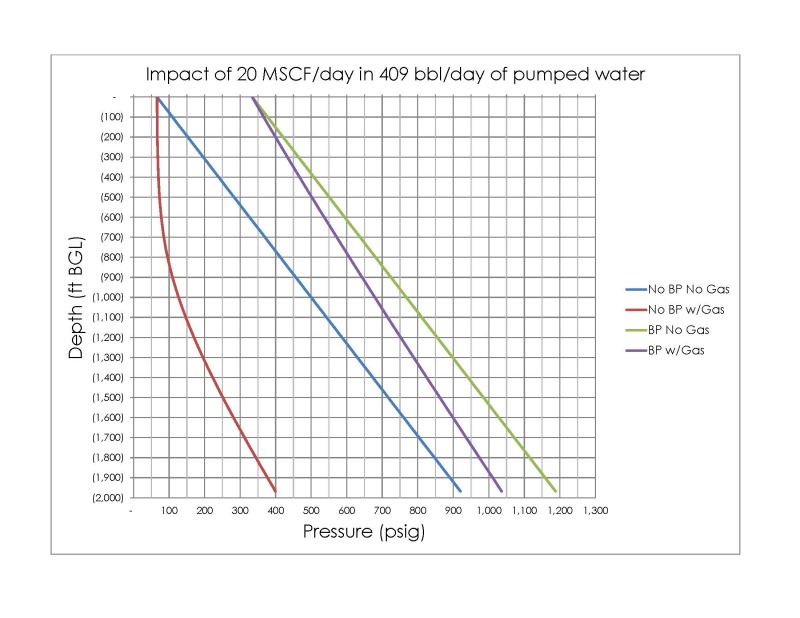

Work I've done since show results like

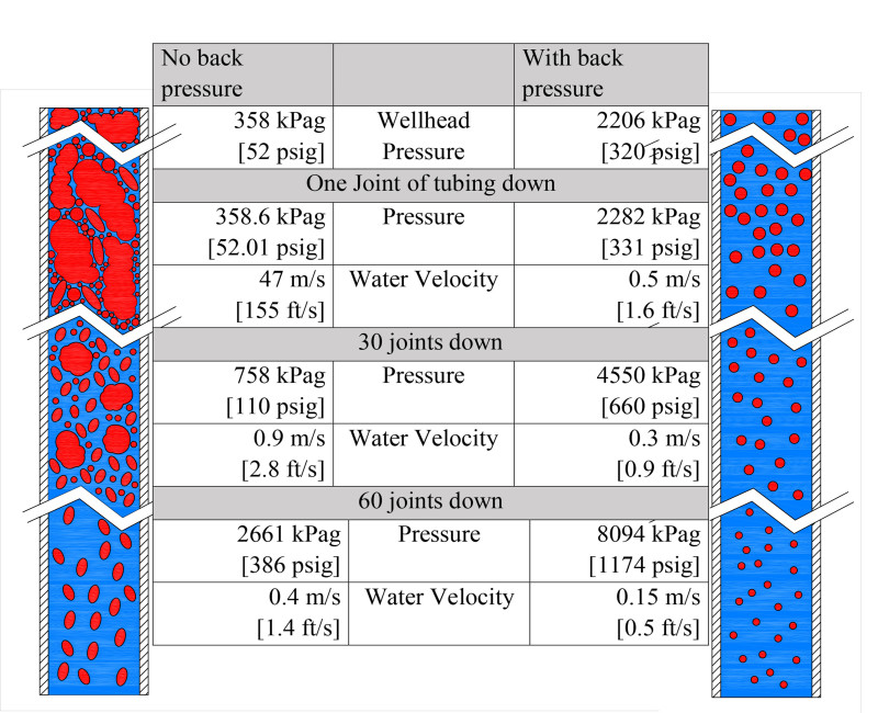

You can see from this chart that the impact on the hydrostatic pressure is very much a function of the imposed pressure at the top. You don't say what the starting FTP was, but it likely was high enough that the physical volume that the gas occupies in the tubing was low enough not to be a significant factor.
If you look at the pressure gradient down the tubing (image below), you can see that my "high pressure" version only has 320 psig on it and the line without added backpressure is nearly straight and just slightly lower than the no-gas line. There just isn't enough of a problem at FTP above about 150 psig to make it worth bothering.

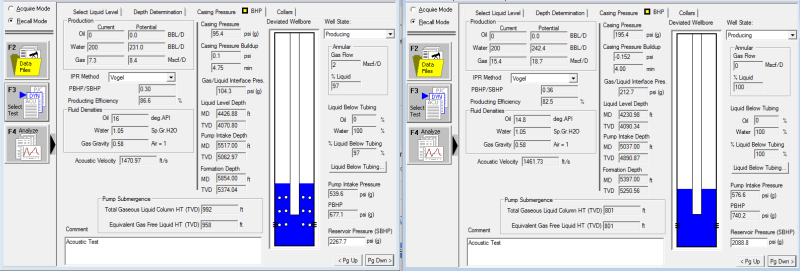

Nick, was the fluid level shot on the left taken earlier than the one on the right? According to the fluid level shot, the casing pressure increased from 95 PSI to 195 PSI between these two shots. Producing BHP also increased from 677 PSI to 740 PSI. Did your flow line pressure increase or did the casing get choked back?
