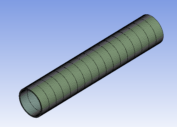

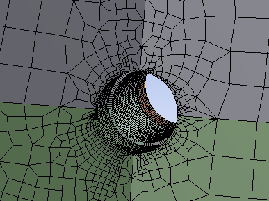

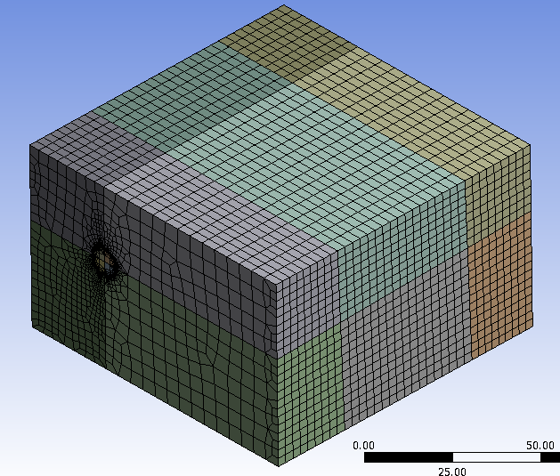

I'm modeling a soil-interaction for a tunnel as can be seen in the following pictures:
Concerning the properties:
Tunnel⇒ Non-Linear Concrete
Soil⇒ Drucker-Prager
First I wanted to use a simple model, so I set all materials as linear.
But when applying this code the process never ends or at least it gives me that idea.
CODE -->

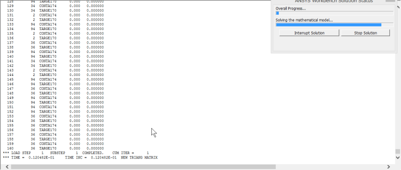

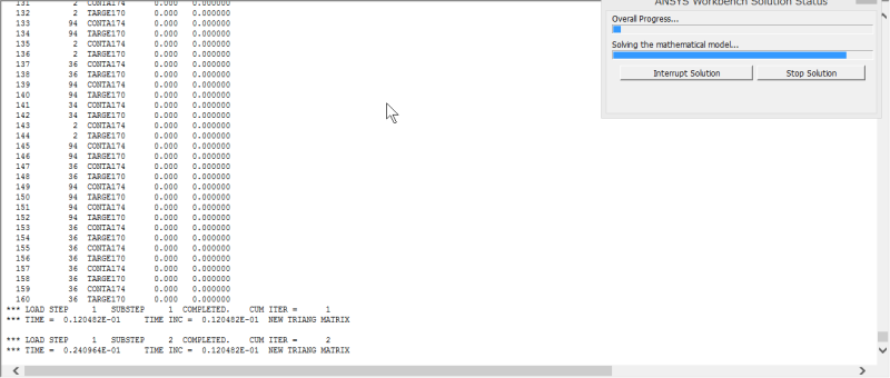

Is it normal that this kind of process(transient analysis for 4899 points of acceleration) to take soo much time? I can leave my computer there all night while is solving it, but I'm scared to receive a warning message telling me that everything I did was for nothing.
Step 1 completed
Step 2 completed
Till now It has finished steps 1 and 2, so By seeing this, I understand That I'll have to wait like 10 hours?!bugeyed Please, Eng-Tips marauders, I summon an almighty ANSYS level 99 wizard user to bring some enlightenment and sound advice to this afflicted and tormented soul.morningmorningmorning

ElPsyCongroo,
Quote (OP)
It's good practice to start with a model that has the right characteristics yet small enough for a quick solution. This allows for quick iterations to catch bugs and test your ideas. After solving a simple model, you could then add increasing levels of complexity until reaching a desired goal. With experience, this process has the added benefit of helping you gauge how long a solution will take. Good luck!
