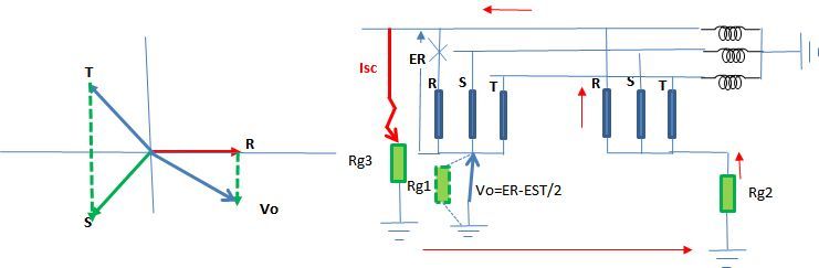

Few utilities add an earthing switch in the transformer neutral point so it can be isolated and wye runs floating?
I think it is meant for maintenance? not really sure why but what makes me wondering is the rating of the equipment connected in the neutral. Namely, Surge Arrestor, CT, DS/ES.
the voltage rating for Q81 and TN1 shall be sufficient to withstand neutral voltage rise in case of Q81 is open and a fault upstream happens, which in the case of Q81 is open, will be 132/Sqrt(3) = 76.212 kV, this corresponds to a line-to-line rated equipment of 132 kV as well.
IEC 60076:3:2013 Annex D provides a formula to calculate the neutral equipment voltage ratings, but in this case the fault current will be ultimately zero as the zero sequence impedance is very high (neutral point float), thus, the full phase voltage is going to appear between neutral and ground, the surge arrestor is provided to avoid float voltage rise due to stray induction and to protect transformer neutral bushing.
In the SLD above, the consultant recommended using a 123 kV earthing switch, and in similar installations I have seen some recommendations going down to 80 kV?!
Any clue about neutral equipment voltage ratings? the need for disconnection at all?

However, ignoring the arcing ground fault concern, the switch would be reated for neutral voltage when there is phase to ground fault, which would be about Vn = 115/sqrt(3) * safety margin. Typical effective grounding says that if X1/R0 <1 and X0/X1 <3, then phase-ground overvoltage on unfaulted phases during ground fault is supposedly limited to ##%. Somewhere along the line I recall seeing a calc that said what the ##% number is, but I cannot put my finger on the matter; maybe someone else can. Another factor is a system is run nominally at 115kV but voltages are +/-10%. Your case it seems ## = 1.2. Seems within reason at least.
RE: Transformer Neutral Equipment Rating
In my opinion, in the case of one phase-to-ground fault [let’s say R] and interrupted connection with the transformer the neutral potential will shift from 0 to VST/2[132/2=66 kV] and then the voltage between this neutral and ground will be:
Um=sqrt(132^2/4+132^2/3)=100.8 kV.
According to ABB High Voltage Surge Arresters Buyer´s Guide Ed. 9.2/2012
for non-effective earthing Uro=1.11*Um Uro=112 kV.[Table 2].
A surge arrester type PEXLIM P-X XN170 Ur=120 kV.
So, in my opinion, rated 123 kV of the neutral equipment it could be taken into consideration.
