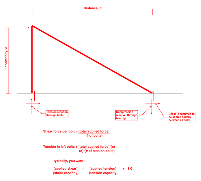

Hi peeps,
This frame will be bolted on the ground. The load applied is shown by the red arrow, my question is how to deal with this loading type. Can anyone recommend an analysis method for the bolts ? I know the bolts are undergoing shear force and bending moment (out-of plane), but I'm not familiar with real life approaches to this problem (Steel code etc.).
Attached are some views to this structure

Agree with others, no bolt group moments. You'll have moments on the frame that will be resisted by tension/compression couples involving tension on the bolts. So just shear and tension.
RE: Out-of-plane Eccentric load on bolted group
Belisario_G, see the sketch below:
Sorry, that last inequality should be less than or equal to (not greater than).
and the shear reactions should be pointed left, not right.
I was in a hurry!

Belisario_G, the sketch and equations by DETstru are very good. The equations are essentially just statics and geometry.
I'm not sure whether you are familiar with concrete code procedures for checking capacities of bolts embedded in concrete (I've been presuming concrete base when you mentioned "ground", but please let me know if I'm mistaken). The relevant code is ACI 318-14, there are some long, convoluted equations for determining capacity, checking a few different failure modes. There are some simple software programs that aid this. But the upshot is that in these scenarios, the potential breakout of anchor bolts from the concrete almost always governs over the actual capacity of the bolt steel.
Belisario_G, the equations are based on simple statics. Any statics textbook will have this sort of thing.
The load, call it "P", acts above the surface at an eccentricity, "e", parallel to the plane of the surface. This creates a moment equal to P*e.
The shear is resisted by the bolts by sharing the load equally among them. So you divide P by the number of bolts to determine the shear in any bolt.
The moment is resisted by tension in the front bolts and compression in the back bolts. Typically the back bolts don't transfer the compression, the frame bearing against the surface does the work. For the front bolts, they are in tension. The resisting lever arm is the distance "d". So you divide the moment, Pe, by "d" to get the tension in the bolts. Then you divide that by the number of bolts in the front since you assume they share that tension load equally.
Once you find the tension and shear in those front bolts, you compare that to the capacity of whatever bolts you choose to use. Let's say:
the shear reaction is 2000 lb. and the tension reaction is 1000 lb.
the shear capacity of your selected bolt is 3000 lb. and the tension capacity is 2000 lb.
In shear, the demand/capacity ratio is 2000/3000 = 67%
In tension, the demand/capacity ratio is 1000/2000 = 50%
Adding these together gets you 67% + 50% = 117%
The bolts are over capacity and you must use a different bolt.

4 bolts (on the A frame) react the tension half of the couple reacting the off-set moment. you could add a moment to these bolts, but that'd appear as a couple rather than bending on the bolts; then, sensibly, there's be a small shear reaction too.
the pad reacts the compression half of the couple.
the shear is reacted by either the 2 bolts under the diagonal, or by the 4 bolts (on the longitudinal member).
