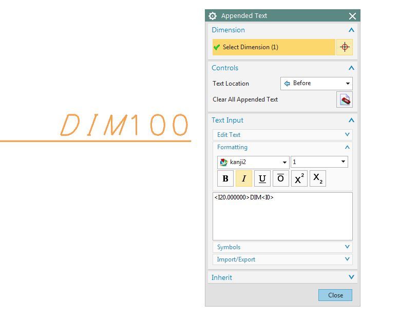

Hello,
Actually i am little confuse how to do the slant text and dimension to straight.
Please help me out of this.

Right click on the dimension or text to edit and select "Edit appended text". Then select the text and click on "I"(Italic)
Ranjith P R
Automotive Seatings
RE: Slant text to straight
Actually sorry for the wrong information from my side actually i need how to do the straight text from slant..
and it is not showing any italic also..

Can you please explain your question ?
Do your partfile display texts as "italic" ?
so whatever text you write, it is italic , like this ?
Or ?

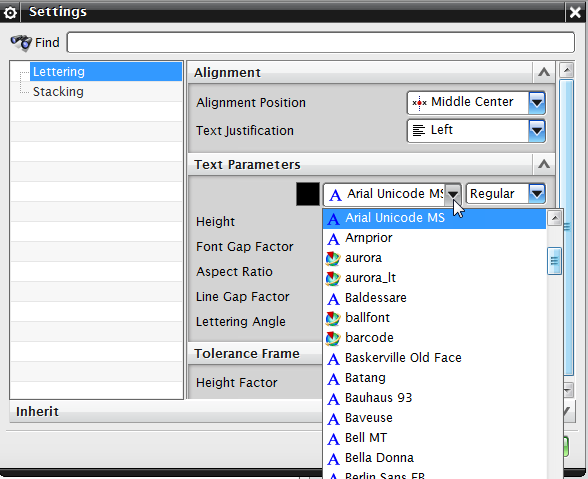

We can help you change your template file, ( you upload it here, somebody downloads / changes and saves the template / upload back to you) But that does not help existing files.
But, If you are running a version later than NX8.5 the simple solution is to change from the "Unigraphics fonts" to Truetype.
Only the Unigraphics fonts are using the CSLANT variable.
"Unigraphics fonts" is a very old definition, it was developed during the time when pen plotters was the method of printing drawings,
Before inkjets, lasers and electrostats.
Regards,
Tomas
Whr to change this unigraphics font to TrueType.
Depending on the NX version,
NX10 : Right click - Settings - Lettering - Text parameters ,
The fonts with a Capital "A" in front, such as "Arial" are True Type , the fonts with a NX icon are Unigraphics fonts.
In the image Aurora, Aurora_lt, Ballfont, barcode are Unigraphics fonts.
Regards,
Tomas
Yes correct we are using unigraphics font which is 'Latin extended'
Earlier it was showing as 'Din'
If we are changing to latin extended still text in slant
Are the Latin_extended a Unigraphics font or a True type ?
ALL Unigraphics fonts are affected by the CSLANT.
True Type is not.
Regards,
Tomas
Latin extended is unigraphics font
