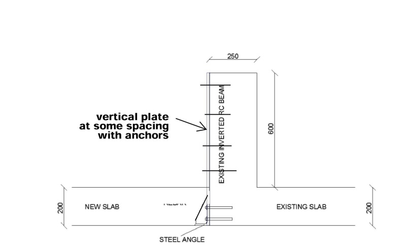

combination of connections: new slab + existing slab
6
What is your opinion on using rebars + steel angle (130 x 75 x 10 mm) anchored to the existing slab for connection: new - existing slab
Im asking this because Im little uncomfortable relying on rebars only.
Rebars are designed on shear (concrete cover above rebars are approx. 50 mm),
Steel angle + anchors are desinged on tension/pullout forces (from bending moment) + shear forces.
Both rebars + steel angle would be designed on full force.
What do you think?

IMHO, Don't do it, the detail is too complicated for the limited space (200 mm, vertically).
Check to see how many rebar dowels are required, but consider that number as just a theoretical minimum. Install as many rebar as will reasonably fit along the existing slab - based on calculations of optimum rebar spacing. Center the rebar (vertically) in the existing 200 mm thick slab.
Reasons for these suggestions are as follows:
1. Each hole drilled into the existing slab is an adventure... will existing rebar be encountered (making that hole unusable)?
... will that hole be aligned (perpendicular to the edge of the existing slab) to allow that dowel to develop it's full load capacity?
... will the existing concrete crack, or otherwise be compromised by drilling (degrading the performance of that dowel)?
Hopefully, the number and placement of usable dowels will exceed the the calculated minimum number of dowels required.
2. Centering the dowels vertically is for essentially the same reasons as given above. That is, to allow a wide tolerance for field construction variation from the design.
Again, this is just my opinion, retrofit design is very different from new design. Existing conditions have absolute control of what can be done. The designer has to work within those constraints, be conservative, and make maximum allowances for field variations.

Probably 25M or #8 for dowels... I like large dowels... Also need a joint perhaps at the top interface with rod and caulk if moisture is an issue. Recently used Hilti TZ anchor with rebar welded to the angle to hold things together...

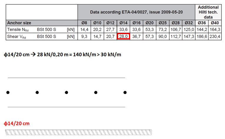

Great post, thanks for elaboration, I appreciate time and effort you put in reply.
Well, design vertical shear force on rebars are around 30 kN/m, which is not a lot. If I choose 200 mm spacing between rebars, that is: 30 kN/m x 0,20 m = 6 kN. based on that M8 rebar would be sufficient.
Based on that there is no need for big diameter, but I think its better to choose bigger diameter of rebar - there is also horizontal shear acting on this anchors in case of lateral forces as earthquake (its hard to determine actual shear forces)and there also may be some issues with deflections at a spot of anchoring in case of small rebars. I was thinking about choosing rebars M14 at 200 mm distance between anchors. Its much more than it is requared, but i think rebars at 200 mm spacing are still acceptable as far as field work/drilling go.
M25 rebars seems like an overkill in my opinion, but i dont have much experience so... perhaps M20 at 250 mm spaing would be better than what I suggested (M14/200 mm). I dont know what spacing between rebars is acceptable (normal) in situation like this.

straus12 - Concur with Dik, large dowels are preferred.
Selecting the size rebar and spacing is a compromise.
1. Existing slab thickness is a major factor - need to keep the diameter of the drilled hole from being too large. Don't want to make Swiss cheese out of the concrete.
2. For the same reason as above, don't want the dowels spacing too close together.
3. However, don't want dowel spacing too far apart... may have to "omit" a planned dowel every now an then because of interference with existing rebar, etc. Don't want that "gap" to the next dowel to be any greater than necessary.
4. As dowel size goes up, both edge distance and dowel spacing become more of a concern.
Taking all this, plus your calculations on dowel loading, I consider your proposed M14 rebar at 200 mm, to be reasonable... but M16 at 200 mm, more conservative, and still reasonable. But it is truly an engineering judgement decision.

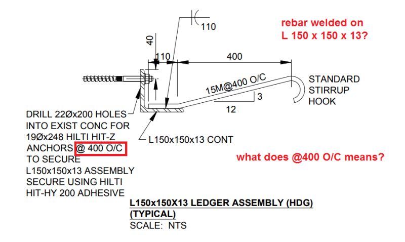

The attached was used for some serious loading on a recent project. The rebar hook was only to hold the ledger angle in place. New 8" slab reinforcing went to the the L section and Hilti's secured the ledger to a wall.
Added: Should have noted that I really like the Hilti TZ anchors...I go out of my way looking for places to use them.
Dik

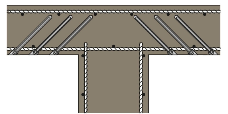

1) Were the bar developed on both sides of the joint, one could consider the dowel contribution per the inclined reinforcement shear friction provisions of ACI 318.
2) Hilti uses an analagous system for punching shear reinforcement which would be a case of vastly higher demand. And that's been validated by testing.

I need some help with understanding dik's detail which I like the most I think. Can someone please tell me what @400 O/C means? that spacing between ancgors are 400 mm?
Also does fi 22/200 means diameter/lenght?
So this HILTI HIT - Z anchors (i used them before) are the only conection between new slab and existing beam/slab right? So that means anchor is design based on shear and tension/pullout (because of a moment).
steel angle is a bearing seat for a new slab and stirrup hooks are welded to steel angle?
KootK - im not so sure about the detail you provided. Thank you of course, but i dont like that top rebar is so close to top edge of new slab. Also I think dik's detail is better and easier to istall?
RE: combination of connections: new slab + existing slab
400 o/c... by default without units, the units are assumed to be inches or millimeters stipulated in the drawing notes. This was a metric project and the 400 is 400mm or roughly 16" o/c.
Added: Only partially answered the question... the 22dia x length is the hole drilled into the wall. The Hilti anchors are the only connection and are mostly in shear. The spec'd anchor is excellent for tension, also, with the wedged shaped sides compressing the epoxy on pull-out. There is little tension because the support angle is well anchored to the slab and rotation is minimal (span was short).
Feel free to use the detail, just check it out first.
Dik

One more thing, English is not my primary language, so I'd like to know what is a ledger?
The angle you show being attached to the existing building is acting as a ledger to support the new slab. In new wood frame construction a ledger is attached to the existing building to support the new framing which will be attached to the ledger and the existing building. The ledger provides a new "ledge" to support the new framing. You can also use a ledger on new framing to help support the new joists.
Hope this helps.

I have been reading this thread and I find it interesting.
However... I do not understand what is the purpose of the rebar with hook that is welded on a steel angle. (Dik's detail)
It was said that it holds the ledger angle in place, but I dont see how? Doesnt anchors hold steel angle in place? Can someone please elaborate this? Thanks in advance.
Quote (greznik)
I believe that it holds the angle to the new slab rather than to the beam (bolts do that). For me, the hooked bar accomplishes two things:
1) The slab bottom steel probably needs to be anchored over the support so that it's flexural capacity out paces tension demand. The hooked bar accomplishes that.
2) Temperature and shrinkage slab strains will tend to pull the slab away from the connection a bit. The hooked bar restrains that. Whether or not that's good is another question I suppose. I'd wager there's enough flexibility in the angle for that to be accommodated.
KootK... and that the slab was fairly heavily loaded, I wanted to make sure there were no bond issues with the bottom reinforcing as well as provide a positive connection for the Hilti anchor.
Dik

Hi kookt, sorry for the late answer. I'm dealing with a deadline so i haven't much time for reading the post.
Maybe longitudinal shear is helping, but as i see it i'm still not sure if dowell will work only in tension. Maybe you are thinking in a trussed action between vertical shear and two relative sloped tension dowels, but if we expect some moment at the joint the lower side of the slab will have a compression zone around the left side of the dowel, in that case probably tension is not being developed. If we expect a pinned behaviour there may be some amount rotation that allows some tension in that dowel but it will tend to be very small, so in both cases right side of the dowel may be acting in combined tension/shear.
I haven't reviewed punching shear deeply yet, but i think it's a different situation, compression will helping at one side of the dowels and wall reaction and tension bar will be holding the reactions (vertical and horizontal respectively) of the tension upper side of dowels. If this is the case tension dowels won't be relaying in the extraction cone only.
