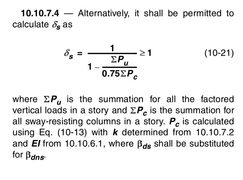

You're right Ingenuity, βds shall be substituted for βdns and can be equal to zero for sway columns, as per ACI 318-11 R10.10.7.4 :
"In the calculation of EI, βds will normally be zero for a sway frame because the lateral loads are generally of short
duration. Sway deflections due to short-term loads such as wind or earthquake are a function of the short-term stiffness
of the columns following a period of sustained gravity load. For this case, the definition of βds in 10.10.4.2 gives βds = 0.
In the unusual case of a sway frame where the lateral loads are sustained, βds will not be zero. This might occur if a
building on a sloping site is subjected to earth pressure on one side but not on the other."

Check out §10.10.7.4 and equation (10-21) where the sway moment magnifier uses the summation of the axial to buckling loads across the entire 'story':
Hopefully your δs does not magnify too much!

Quote (hamza41)
and my factored axial load is around 800 kN
Assuming 800 kN is for your INTERIOR column factored load, and then assuming that the EDGE column factored loads are 400 kN (50% trib area) and CORNER column factored loads are 200 kN (25% trib area) then:
ΣPu = 3 x 800 + 12 x 400 + 4 x 200 = 6,500 kN
Further assuming all 15 columns have the same rebar size and concrete strength:
0.75ΣPc = 0.75[15 x 1200] = 13,500 kN
So 'plug and chug' into equation (10-21):
So basically doubling your sway moments.
At 1,200 kN factored axial load your corresponding moment capacity is about 500 kN.m (assuming you have 35 MPa concrete and 1.5% reinforcement).
