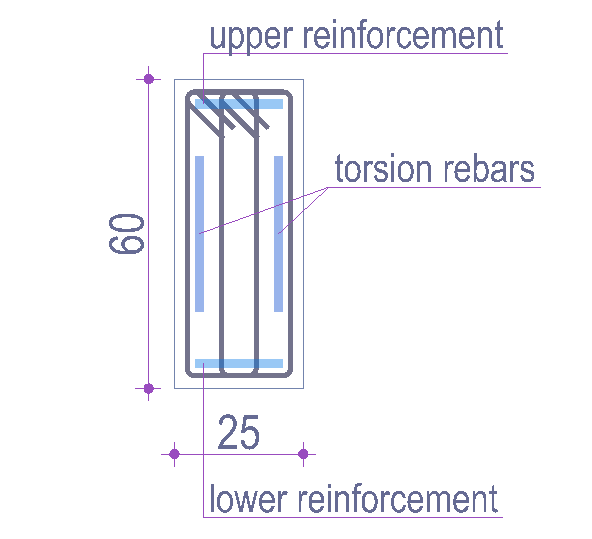

I am trying to design a 2.10m x 6.42m cantilever slab (200mm thick) and the accompanying beam (section: 250x600mm, clear span: 4.60)
that would have to carry the load in order to keep the slab standing.
My initial observation is that its impossible to design the beam reinforcement.
I kept increasing the reinforcement just to observe but it still fails under "Composite Shear-Torsion verification".

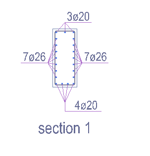

Currently i have 14fi26 for torsion and 7fi20 for bending which is overkill I also have 10mm stirrups with four bars resisting shear.
Therefore now i am trying to think of ways to reduce the torsion transferred to the beam by the cantilever slab?

This. In these situation, it is generally expedient to take advantage of the compatibility torsion concept. Google "compatibility torsion concrete" and you'll find ample information, much of it located here. The procedure is as follows:
1) Let the beam crack and shed it's torsional stiffness. Post cracking, the beam's torsional stiffness will drop to 5-10% of it's uncracked value.
2) Run your model assuming zero torsional stiffness in the beam and design the slab accordingly.
3) Provide your beam with a minimum quantity of torsional hoops, as defined by the governing concrete code, to allow the beam to redistribute its torsion and convert it into additional slab flexure.
This a very common procedure in design offices. If you instead try to increase the torsional capacity of the beam, often you'll wind up chasing your tail because that additional strength begets additional stiffness. And additional stiffness begets additional torsion.

1 the torsion results in moments into the columns. if there was no restraint to the beam rotation, there would be no torsion in the beam. The columns provide that torsional rotation restraint.
2 If there is no torsion, the cantilever deflects further as part of the rotational restraint at its support disappears.
You cannot assume compatibility torsion and ignore it without considering the effects of no torsional restraint on the remainder of the system.
Size the beam to be able to take carry the torsion and design it like it wants to act!

IIRC, if you use the compatibility torsion solution, you still have to be sure the beam can resist a certain level of torsion (provided for by ACI 318-11, Section 11.5.2). It's been my experience with this equation that the level of torsion this yields is typically higher than what the design torque would be anyway. However, in your case, with a cantilever slab, it might be less. Just something you have to run.
If you do have to estimate the torsional stiffness of the girder (i.e. the compatibility solution doesn't work)......a good means of estimating that stiffness is in 'Analysis of Structural Systems for Torsion' (ACI SP-35). In particular, see the chapter on post-cracking stiffness, p.410 (for a example of it's calculation), and p.425 for a chart showing the ratio of cracked torsional stiffness to non-cracked (for various) parameters of reinforced concrete. (In general, the GKcracked/GKg ratio is equal to about 0.05 to 0.2 in my experience.)
Just a general comment on your design: I've never had a 6' cantilever slab be an issue for just personnel traffic....if there is a problem, you may want to make your beams deeper. (Not sure what the dimension actually are: I see one plan view that shows 500-600 mm and a cross section that shows "60".)
