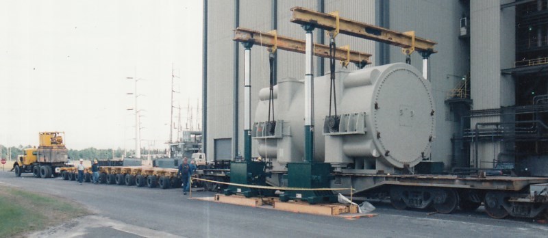

This incident will "blow over" soon. The Rhode Island DOT is having a justified "fit" since Bay Crane did not obtain a permit. Trailers of the type used (16 axle, probably 8 tires per axle) are designed to limit axle loading to legal limits. There "may" be a "problem" only if a structurally deficient bridge had a very long span. Photos of the trailer show:
8 axles ahead of the load
No axles under the load
8 axles behind the load
On bridges with short spans no more than 8 axles will be on a span at one time.
There is news "talk" about disassembling the generator to move it in lighter pieces... that is not going to happen. What is on that trailer in a generator "stator" (not a complete generator) for a multi-hundred megawatt electric generating station. It is basically an iron core with heavy copper windings. The (ligher) rotor is shipped separately. There is nothing about a stator to disassemble short of destroying it's usefulness. If there was, the stator would be shipped as component parts to be assembled on-site.
We had to move a 400 kip stator as short distance on a 12-axle trailer (by a specialty Contractor). Here is a photo of the stator being transferred from a dedicated transport railcar to trailer. I performed planning, contract prep/bid/award, and field construction management for this project.
