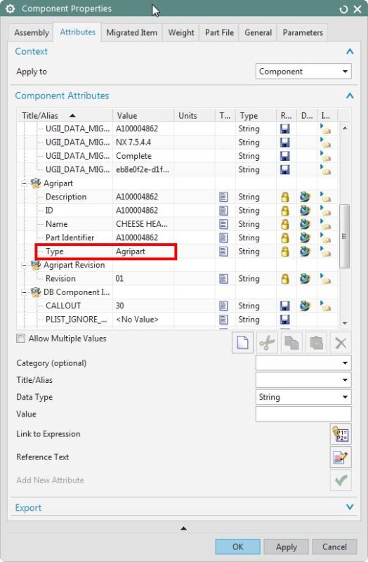

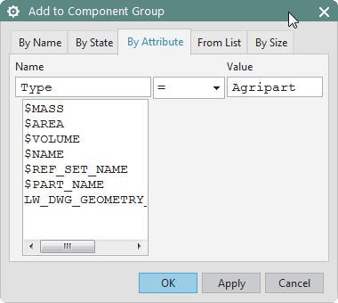

I'm trying to work with Components Groups and Attributes.
In an big assembly I want to hide all bolts, nuts, rings etc. All those kind of part have an attribute with the name "type" and value "Agripart".
So I tried to create a component group by attribute with the filter "type = Agripart" but for some reason it's not working. (see images)
I tried some other attribute names with only the value "exists". For some attributes names this is working, and for some not.
Why are some attribute names recognized and some not?
Anyone an idea?
Using NX 10.0.3.5 and Teamcenter 11.2.2.1 on Windows 7 (64)
