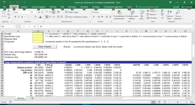

with modern procedures (full/partial Newton solvers) tolerance in convergence is not (normally) a problem, I attach an example of distillation column solved in Microsoft Excel with the free version of Prode Properties, as you see errors are really very low,
however for ppm values a solution couldn't be available, even with 200 or more trays...
also we must caution users (see my previous post) that improper selection of thermodynamic models can introduce very large errors,
for example if you select ideal / vapor pressure model for very non-ideal mixtures,
the same for enthalpy etc.

This is indeed new to me, but am curious what Prode / MS Excel means by lumping both mass and energy balance into a single tolerance output. If my memory serves me right, mass and enthalpy errors are reported individually for each iteration loop in Pro / II. I'd also check this simulator manual for default global convergence tolerance limits to see if these match this output.

the Excel page reports the errors as (Win/Wout-1.0) mass balance and (Hin/Hout-1.0) energy balance, it's in Excel VBA code, you can show separately the errors and/or adopt different formulations, there is a free version (for students) "http://www.prode.com/en/distillationcolumn.htm" if you wish to test and/or compare, as you can imagine there are limits (comparing the free with commercial versions), no global convergence (required for difficult specifications), no reactions, no batch etc.
but the 64 bit version is very fast and I use it regularly with Excel and Matlab.
