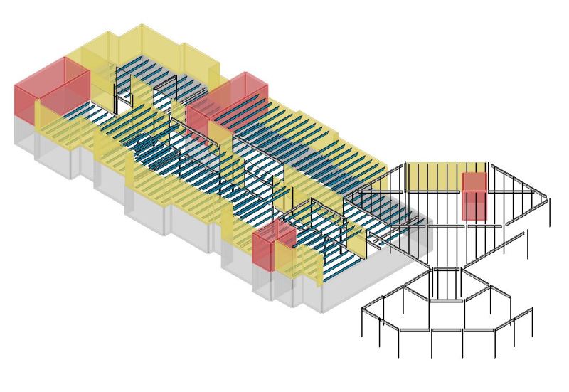

Thanks for all the recommendations gentlemen. However, I feel that we're mostly picking the low hanging fruit: steel and concrete jobs. It's really the sprawling light gauge and wood projects that represent the bigger (and more obnoxious) time suck for me.
The clip below is from a RISA model for a project that I'm working on. Light gauge walls and steel joists in the wings, straight steel in the core. Two stories up with interior lines transferring out at a partial basement. Modeling so far has been... okay. It was probably overly ambitious to attempt something so messy with software that I'm not all that familiar with any more (lost my modelling V-card to RISA back in 2001).
I've still got a ways to go before I'll know if the model will produce the kind of results that I'm looking for in these kinds of buildings. And there's a nagging voice in my head perpetually repeating the phrase "just suck it up and do it by hand". But, alas, this is an experiment that I feel compelled to try every few years to see if software has yet caught up with my hopes and wishes with respect to how lazy I might eventually be allowed to get.
An interesting conundrum here is the complexity of going back and forth between walls and column down a bearing line. For a lot of reasons, you want a contiguous framing line. It makes deck assignments much easier etc and the model doesn't appreciate gaps in the support line. On the other hand, if I let the walls and columns touch, then they mesh together and what I hope to capture is lost, or at least more difficult to parse out. I'm considering running a gravity version of the model with the shear modulus of the walls tanked so that the adjacent columns might retain their load. I'd appreciate recommendations in this endeavor. There's a "physical member" feature in RISA but I haven't yet ascertained whether or not that would get me where I want to go.
RE: Software Recommendations for Load Take-down
I think unchecking the physical member box should get you what you're looking for. See below.
https://risa.com/news/how-to-model-column-within-w...
By the way if you're a big Woodworks guy, I would definitely recommend Simpson CFS for light gauge sizing. Its very easy to size beams/joists/studs in and also does shearwalls and stud walls with openings and checks everything, including headers and sills, for axial and out of plane loads. Also the latest update lets you do multistory wall elevations.

I'm in the same boat. On complex residential projects I find myself using so many different programs and spreadsheets it is a nightmare. I have tried risafloor and 3d for it once or twice but floor can be a real pain with multi-level and pitched roofs. Gerry has an interesting workflow though, I will have to give that a shot.
Quote (dnlv)
Maybe. I'm working in RISA floor right now which presents two possible problems:
1) How do I efficiently go around and raise up all of the column top nodes 1"?
2) Much of the "goodness" of RISA floor is contingent on hard defined floor levels. I'm scared to mess with it.
This may indeed be the way to go once I've got some time on my hands to explore it leisurely. 2035-ish.
@Gerry: your work flow is almost identical to what I've sort of arrived at through trial and error. Except that I'm doing bottom up. Not really sure why or if there's an advantage one way or another. How are you handling truss loads for complex roofs? I was able to realize a chunk of what I'd hoped for by modeling my girder trusses and then representing the commons with one way spanning deck. I can pull my gravity and uplift loads out of the model pretty fast this way. With the framing plan already conceptually sorted and the support lines already modelled in RISA, it took me about 45 minutes.
One of my hard learned lessons here has been one that you've obviously already encountered: do all of the drawing in CAD. ALL. Native capability in that regard is almost non-existent. No doubt that's by design but I'd still prefer to be able to do some touchup work without having to re-up the CAD.
I think moving all the nodes up wouldnt be too much of a pain, just grab them all and use the move node tool. But I definitely understand your hesitation in not wanting to compromise the floor model, it might screw with the lateral load distribution and the column bracing, or lead to a never ending string of the dreaded P-delta error. In the past I have also split walls at the columns and separated them by an inch or so, then connected the top of the column to the adjacent walls with rigid links, obviously that would be rather tedious at the scale your working on.
