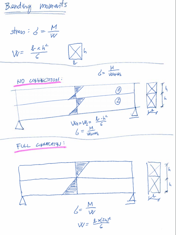

Thanks for answers.
I got another question about bending stresses.
If we connect both beams properly we have a composite cross section that acts as one element.
But if we dont connect them at all, how do you control bending stresses?
are equations bellow alright?
Im wondering can you add up section modulus (sum W1 + W2) of cross sections when beams are not connected?

RE: shear forces acting on two unconnected timber beams
The moments are distributed by the relative stiffness (moment of inertia), not just by the section modulus. For beams of uniform materials and width, this is the cube of the relative depths.
I.e. if one beam is twice the depth of the other, it will be eight times as stiff and suck up 8/(8+1) or 88.9% of the moment.
So, yes, you can simply add the section moduli, but only if they are equal. The moments of inertia can be added directly regardless of the relative depths.
We have discussed this at very great length before: http://www.eng-tips.com/viewthread.cfm?qid=379229
But for full length beams of equal cross section the answer is simple: both beams have the same curvature along the full length, so they have the same bending moment, so they must have the same shear force at any section, so they both have 50% of the total shear, assuming plane sections remain plane etc.
Of course in the real beams the shear force doesn't transfer to the support at a vertical plane at a point support, but the end shear transfer mechanisms are just the same as for a single simply supported beam, so on that basis taking 50% of the shear on each beam can be justified. On the other hand, it's an unusual situation, so KootK's 60% rule also seems reasonable to me.
