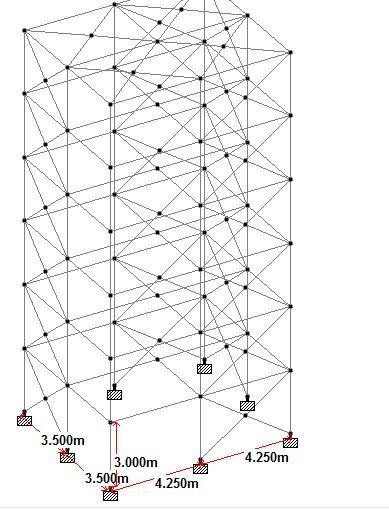

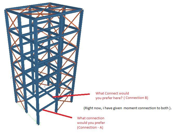

I have to design a five story steel frame for factory/storage. I have modelled it as a BRACED FRAME FROM ALL SIDE WITH ALL MOMENT CONNECTIONS, for the time being.
But i was wondering, as the frame is braced i could change the connections to pinned. OR Periphery Beams to column connection as moment and others as shear?
OR you would suggest something else?
PLEASE LOOK AT THE ATTACHED PICTURE
Thanks in advance,
Student structural engineer

If it's a braced frame, then it's wasteful to specify moment connections. The braced frame portion will be significantly stiffer than any 5 storey moment frame.
RE: PLEASE HELP - Moment or Shear Connection ??
If braced with floor diaphragms, all joints can be pinned.
Dik
You can mix moment frames and braced frames in the same building, but not in the same connection. For the moment connection to work, the frame needs to move laterally. Your braced frame will be so stiff that it will never move enough laterally to engage the moment connection.
Shear because it's braced. The better question is, should your support be fixed or pinned? Right now you have it fixed, it maybe pinned.
Definitely braced. (If you have a diaphragm to distribute the forces.)
By the way, be sure you can place the braces as you show them (especially the horizontal/plan bracing on the top floor). Usually in a manufacturing facility (even if it is for storage) you are running into someone else's space with a brace layout like that (i.e. HVAC, piping, etc).
