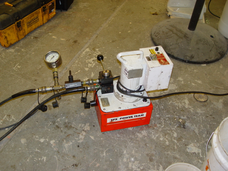

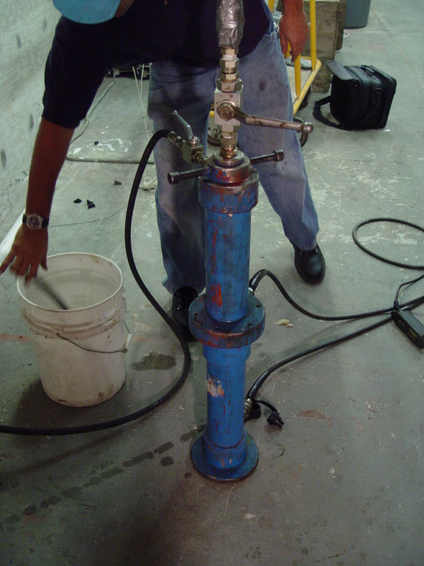

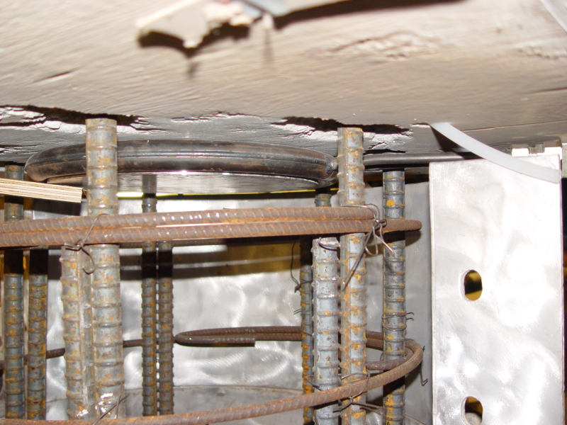

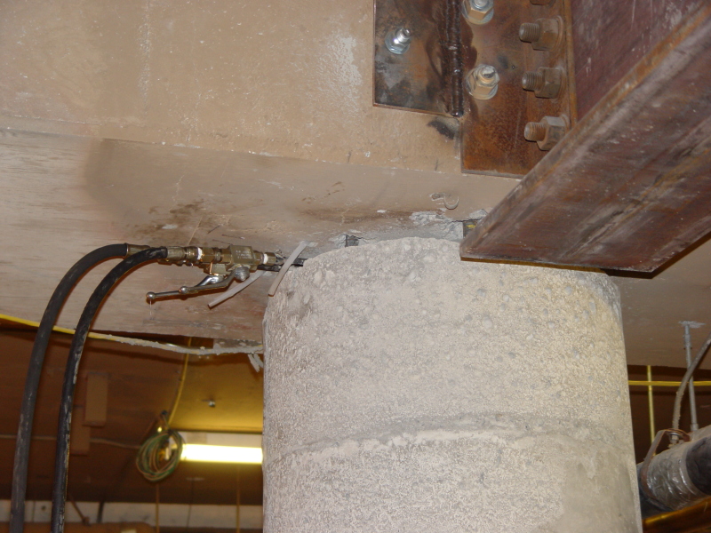

Quote (rapt)
We used to use flat-jacks
rapt brings up a very useful 'tool' for such applications. Flat jacks (one of the many original patents by Eugene Freyssinet) are a very compact/high-capacity method of pre-loading.
I have used them on several projects - from small 8" dia to giant 36" diameter ones.
We have our own equipment, but the hydraulics are readily available for rental in the US from WB Equipment Link. I think WB also provide site-services too, across the US.
For smaller-diameter permanent flat jacks it is possible to pre-load the structure via flat jack/s with hydraulic fluid, then (without de-loading) pressure pump in 2-part epoxy resin into the flat jack using a simple hydraulic pump and 'rocket' whilst flushing/bleed out the hydraulic fluid. Avoids have to place shim/packing plates etc.
Here are some photos of a project we were involved with for a transfer beam with new micropiles that required pre-loading:
It does require some specialized experience, but not too complex.
