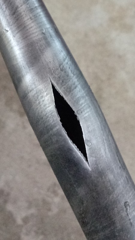

Well, I had the units tested again today and had some interesting results. The use of the water jacket during the test definitely was the cause of the bizarre readings I was getting and what left the impression of the leak. I am curious why this was the case but when it was in the water jacket, we took the pressure up to 6ksi and the water level in the water jacket began to rise, suggesting a leak. The pressure was also fluctuating quite a bit. When this occurred, we maintained the pressure and removed it from the water. As soon as the the vessel was removed from the water jacket, the pressure stabilized and no longer bounced around. We put the unit back under water and brought the pressure up to around 9ksi. The gauge began fluctuating quite a bit and then the vessel failed. The gauge was around 9ksi when this burst occurred.
Does this look like a typical failure?
So to investigate this water situation, and since the water in the chamber was released when the previous vessel burst, we tested the second unit without the water jacket. In this instance, there were no pressure fluctuations and we were able to keep it at 9.5ksi for about 10 minutes without pressure loss. I am not familiar with the water jacket testing so I have no idea what the issue was or if the burst pressure was legitimate since the vessel itself should be good up to 11ksi before yield. I can only wager that there was some sort of issue with the test apparatus and/or due to the use of such a small vessel in a large cylinder test chamber.
I also used 2 different thread sealant methods, one being liquid sealant and the other being mil-spec ptfe tape. Both sealed the vessel and there were no visible leaks around this connection when observed. The main purpose was to ensure the brazed end caps would hold and they did (quite incredibly). So its been an interesting situation, thanks for all the help. If I had access to a better testing facility, this likely would have been avoided completely; however, gotta make due with what's available.

You really mean 0.065" thick and 1" OD ? You are about at 1/3 the required thickness for 9 ksi, so no surprise it failed with that very classical pattern.
You better go back to the 'designers' and beat them on their heads, telling them they should not put you into such a danger...

We don't know the strength of the tubing. If smys》70000 psi you're ok, but are at the mercy of any small thinning or damage.
What the pressure fluctuations are I can't work out.
RE: Hydrotesting of custom pressure vessel
Yeah, I checked the certs for the tube and the yield was 70ksi and ultimate was 80ksi. Given the numbers it should have destroyed the tube at 11ksi. That one that burst was actually a little less than the calculated pressure it could hold. I think it burst at 9ksi(if that was the true value given the weird fluctuations) due to some rusting, since these were the same that I tested originally and the water had taken its course over the next couple days before the retest. Or it was because of some uneven thickness in the tube or just some shit tube from a different lot than the certs I received.
