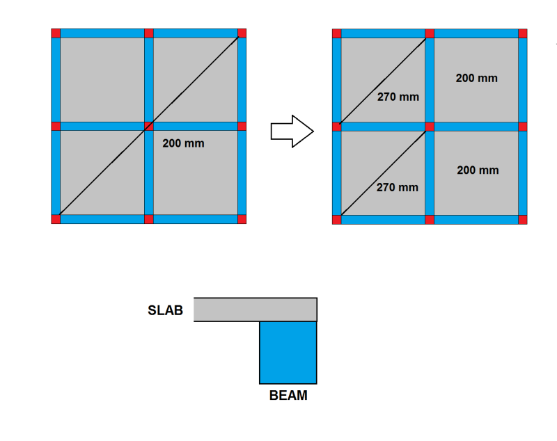

Interesting... I got a question too:
What if you want to do that only on a part of existing slab? Is there a problem?
Lets say that load is larger only on half of existing slab. Does that mean you still have to add a new layer of concrete above entire slab or is it ok to do it just where you need it?
red - columns
blue - beams
gray - slab
RE: what options do I have?
n3jc - Unfortunately, there won't be a simple answer; too many related changes:
1. The topping increases the dead load of it's portion of the (elevated) slab.
2. But at the same time, the topping increases the structural capacity of it's portion of the slab.
3. How much the topping increases the structural capacity depends on the details (reinforcing, edge conditions, etc.) of the existing slab.
4. Nothing was done to a portion of the slab, but the changes where the topping is applied will affect the unchanged part.
5. Revised live load rating, will affect each part (topped and untopped) of the slab differently.
Will have to make assumptions and see what the calculations say.
