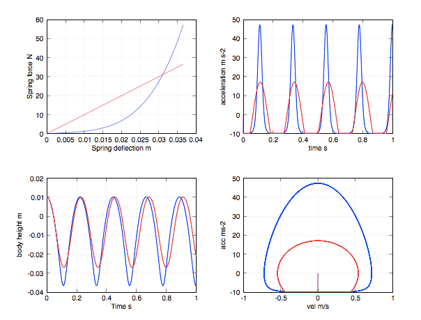

I'm trying to solve for the displacement of a mass with an applied constant load. Initially, there is a gap between the mass and spring, that is quickly overcome due to the applied force. The spring has a variable springrate. I have searched through multiple books and internet sites to find an example problem with a variable springrate and have had no luck. Again, this is an undamped case single degree of freedom case. Any suggestions?

That's quite a funny one because the mass will bounce free of the spring on every cycle. I'd solve it numerically, but I suspect an energy approach might lead to an analytical solution for some non linear stiffness curves.

Yes. start with Newton. Work out the forces on the mass at each time step. That gives you an acceleration. Add a*dt to the velocity from the previous step. Add v*dt to the displacement from the previous step. Rinse and repeat. Test it on a linear spring and zero airgap first, that way you can check your answer analytically, w^2=k/m
That is rather inelegant and relies on very short dts but it will work.

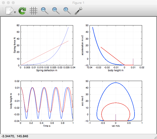

I get that a 1 kg mass with a 0.004 m airgap and the following spring force=100.*displacement+30000000.*displacement.^4;
has a natural frequency of slightly more than 4 Hz and compresses the spring by about 35 mm.
