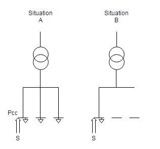

The Thevenin equivalent is the network, Snet means produced power minus used power (net) from the DG (PV, wind, CHP, etc...). The fault current is measured in the Pcc, that's the interface between the grid operator and the consumer (and due to DG, manufacturer).
So my question still stands, but i can try to clarify it with a figure:
Is the fault current/level in the Pcc depending on the numbers of other buses in the LV radial (situation A vs. B) ? For me it seems pretty obvious that the total source impedance seen from the Pcc (in a thevenin equivalent) is smaller if your neighbor has a big demand of power (i.e. one or both neighbor buses in situation A have a big power demand), and thus the voltage rise in the Pcc will become smaller (?). Said in another way; How does the topology of the LV distribution network affect the source impedance? Bigger impedance seen from the Pcc = bigger voltage rise (formula 1, post 1) - but if your neighbor in some way uses all your PV-made power, should this impedance then be smaller?.

Your neighbours heavy use will create a voltage drop in the radial. That drop will be dependant on the grid impedance. Even if all your power goes directly to your neighbour, you will offset some of that voltage drop, based on the grid impedance.The change in voltage at the PCC will depend on a change in current on the radial. Injecting power will change the current in the radial and that change combined with the grid impedance will determine the voltage change at the PCC.
Bill
"Why not the best?"
Jimmy Carter
RE: Grid connected DG - Model for estimating Steady State Voltage Rise in Point of Common Coupling (Pcc)
In many short circuit studies, the effect of load is ignored base on a few factors:
*Fault current is often 10x or more than the nominal current, so the resulting error is less than 10%.
*Fault current is mostly reactive, whereas load current is mostly real. When doing the vector math, the real component often has a very small impact on the overall fault magnitude.
*We like a single number as an answer, but including the whole range of possible nominal loads would require many more fault simulations.
Many fault calculation software packages can calculate faults either with or without nominal loading. The big challenge is creating the nominal loading basecase(s).

Waross: Thanks for the reply! In the first post i wrote that i didn't understand how you could estimate the voltage rise from the formula when not considering other power sinks in the radial (and the impedance in the formula is calculated from the fault current). But bacon4life pointed things out.
Bacon4life: Thanks! Your last post was very informative.
I have one more question:
When estimating the voltage rise, some books/reports/literature in general use only the grid impedance between the distribution transformer and the Pcc, and not the "whole" source impedance (like the book I mentioned). Is his because the impedance upstream from the distribution transformer is pretty small compared to the LV impedance?
Most distribution systems have voltage regulators, either for the whole substation bus or for each feeder. If this is the case, you are may only be concerned with the voltage rise on the distribution feeder because the voltage at the beginning of the feeder would be kept constant by the regulators. If the regulators use line drop compensation, you may have to include the regulator controls in the calculation because the DG will change the voltage at the load side of the regulators. This is particularly true if the DG causes reverse power through the regulator.
