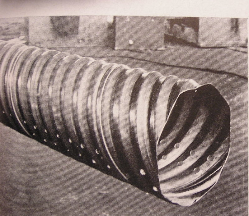

RE: Safe to dig beside foundation for drain tile placement
Here is a photo of the Armco drainage pipe, not made any more. However, look at the position of the holes, leaving a flow path without holes.
While they were 3/8", I would think 1/4" would work fine for a typical footing drain not carrying a lot of water. Then even the finer fractions of sand would likely stay put.
