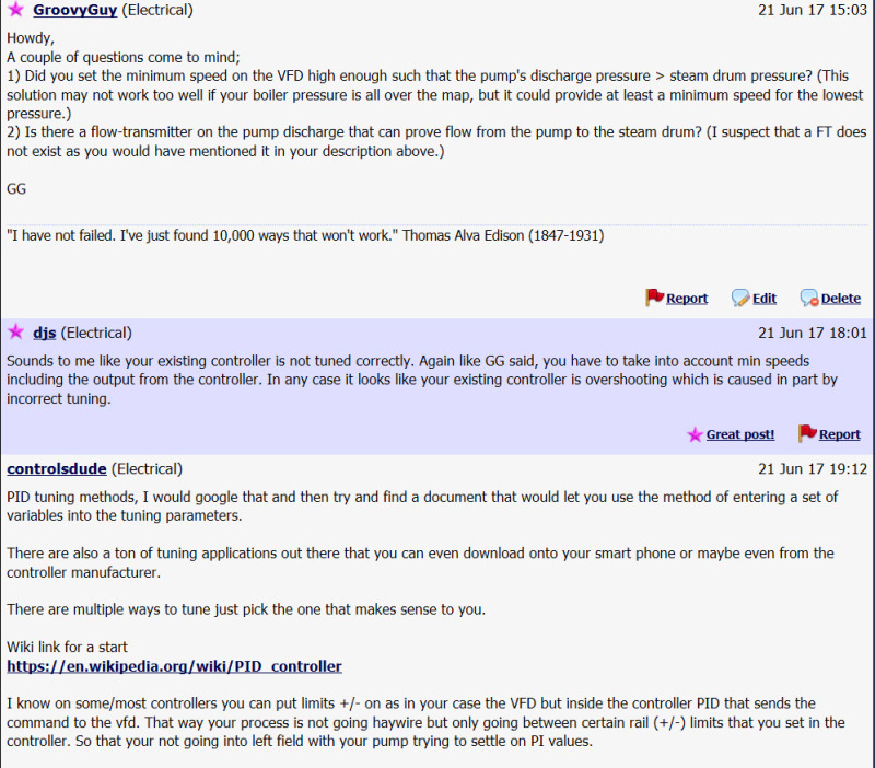

Howdy,
The very nature of a PI controller should make this a simple loop to configure and tune. ie as the level drops in the steam drum, the speed of the pump is increased until the level is satisfied.
In theory, keep the pump running at a speed to ensure that the pump-pressure is > boiler-pressure (ie always flow into the steam drum).
The problem here is if the steam drum level is at or above setpoint, the pump speed will be decreased to a point where there is no flow (ie pump discharge-pressure < boiler-pressure). There is no issue here with the VFD or the motor, however the pump may not take kindly to running in this mode for very long. If this is a problem for the pump, then the only option that you will have is to turn the pump off until such time that the steam-drum level is below setpoint. At that time you can re-start the pump and enable the PI controller. The good news here is that with VFD control you can re-start the motor as often as required (without melting the rotor).flame
Does this seem reasonable?
GG

Thanks for the help guys
@PNachtwey yes we have pump curves from which I can calculate the speed at which the pump should be running to overcome the boiler pressure at the moment
@GG so the general idea is to set the VFD to run at a minimum speed at which pump pressure can overcome the boiler pressure at which we are operating at.

Howdy,
Yes, I agree with you in that the preferred method of operation is continuous level control, and not starting / stopping the pump. Stopping the pump would only be required if the steam-drum level is > setpoint for a period of time. This is only for the protection of the pump, since I assume that the pump does not like to operate in this mode for an extended period.
Stopping / Starting the pump should be a rare occurrence; it is only suggested here as a means to protect the pump.
Other means that I have seen implemented include a bypass loop around the pump to ensure a minimum circulation thru the pump at all times. This is as expensive option since you would require a control-valve on the bypass loop.
