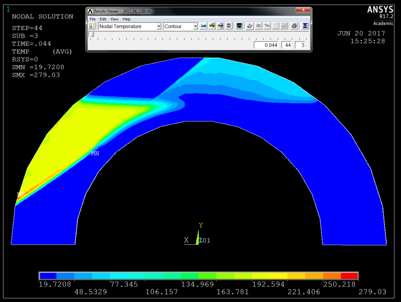

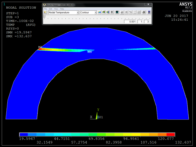

I will add some captures to ilustrate. In the images only half of the model has been Meshed and the mesh is a lot coarser tan the one I would need.

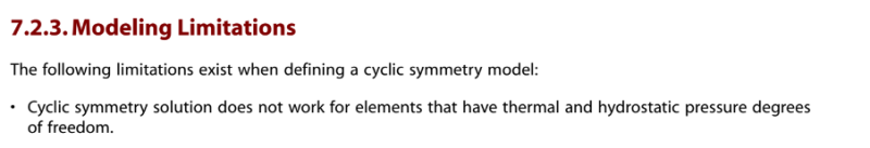

I have already tried the Cyclic symmetry but unfortunately the ansys guide that explains it says specifically that with the termal DOF is not posible to apply cyclic symmetry.
Thank you anyway, this would have been a perfect solution. What I am trying to do is the Cyclic symmetri but manually.

Quote (OP)
...but unfortunately the ansys guide that explains it says specifically that with the termal DOF is not posible to apply cyclic symmetry.
I was surprised by this statement. The help document seems to say thermal DOF is possible. I was able to run a simple thermal transient cyclic symmetry model by applying a small heat flux on a small area on the inner diameter.
Best regards,
Jason

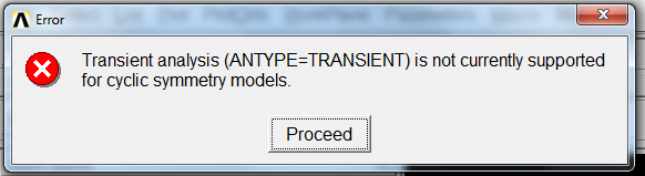

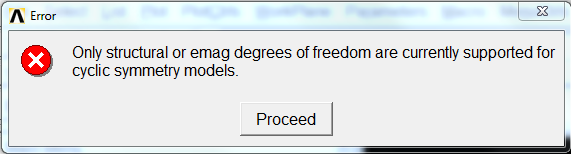

RE: Model Conduction as Convection
Hello again.
I have also made a simple model in ansys but I have recieved this two error messages.
I am using the Academic version of the ANSYS Mechanical APDL 17.2. This is the one I have available and maybe this is the problema, that the transien termal analysis is not available in this version.
Thank you anyway!
