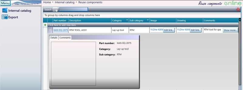

We manage something similar for reuse components and standard parts. For each new component we get automatic part number. All the data stored in database with links to a drawing and image. All standard database methods are applied on catalogue (search, update, delete,create). No part image on screen (Connected to different DB)
App developed by me. We don't have PLM so I had to develop some like you said semi-PLM.
