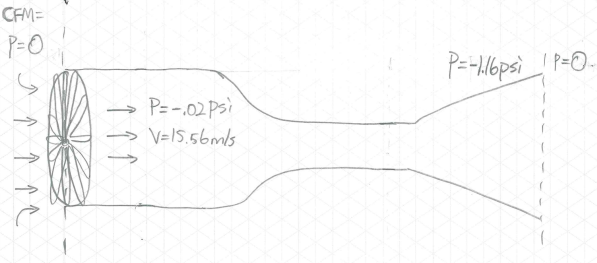

Hi all,
I am wondering if anyone can help me with fan selection for a open circuit wind tunnel design. I understand that the fan static pressure is required in order to select a fan, but I am not sure what exactly is the pressure value for this wind tunnel design; I am attaching a sketch for the wind tunnel below.
The pressure at each end is atmospheric pressure since its open circuit. The theoretical fan is located at the front of the tunnel, which would theoretically produce a flow of 15.56m/s flow speed and -.02 psi static pressure. Right below exiting the outlet the static pressure of the tunnel drops to -1.16 psi. In this case which value would be the static pressure needed to size the fan? Would it be -.02 psi or -1.16 psi or is it something else?
Thank you

Pick one system of units and use it.
PSI is a non-typical unit of pressure for "fans".
Fans increase pressure. Your sketch shows a fan that somehow decreases it.
Air flows from high pressure to low pressure. How does the air leave your tunnel on the right?

I am not really familiar with fan nor wind tunnel lol. So say if the fan chosen has static pressure of 4 WC (which I assume is the typical unit of pressure for fan?), then the pressure right after the fan would be 4 WC? Then the design criterion becomes to choose a fan which would produce a high enough static pressure for the outlet pressure to be greater or equal to atmospheric pressure?

First, fans create both velocity pressure and static pressure. Your diagram shows decreasing ststic pressure which, given the evasee, meets the laws of physics. Total pressure = static pressure + velocity pressure

Yeah I have the dimensions for the tunnel and curves for the contraction cone, and the pressure, velocity, density and temperature at each section of the tunnel are all calculated under compressible air condition. I am just not familiar with fans at all, so I wasn't quite sure how to approach that.
Sorry for keep bothering you, but is the fan selection the concept as pump selection? You map out the system curve and choose a fan curve and the intersection point is the operation point?
And also does it matter if the fan I choose is an axial fan or centrifugal fan, or if it's located upstream or downstream, the selection process should be the same (map out two curves and the intersection is operating point), right?

Quote (sen_yang)
Fundamentally, yes. But with fans there are other factors to consider as Willard said.
Is 15.56 m/s the absolute maximum velocity the wind tunnel is intended to test at? It is useful for wind tunnels to be able to adjust their velocity in the test section, so you will want a fan that can handle the absolute maximum air flow/velocity and associated pressure drop through the tunnel.
Have you factored in pressure drops for different objects in the test section?
Quote (sen_yang)
Yes, the shapes of the fan curves vary. As does the velocity profile off the fan.
Quote (yen_sang)
Not really, but very possibly. This choice has many variables that need to be considered, not all of which are a matter of velocities and pressure drops.
Things to consider are construction of the wind tunnel and how well it handles negative vs. positive pressures.
Where are you pulling air from, where is it exiting?
