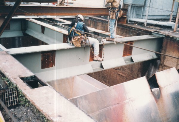

I have used slip-critical connections on my own designs only once - the replacement and upgrade of structural steel for a railcar coal loader. This type unloader is essentially a ground level railroad bridge over a pit. The steel supports some of the heaviest locomotives and fully loaded rail coal cars made. While on the steel, the loaded coal cars are "aggressively shaken" to ensure all the coal onboard is bottom-dumped into the pit. Because of the heavy loads, vibration, and the potential consequences to the CSX trains from connection slippage during use, I considered slip-critical justified.
