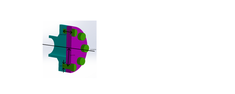

Could you post a picture of the setup which shows the variables and the path?
RE: Stress Paths in APDL
Certainly. It is a simply bolted flange type arrangement
My apologies for the poor quality sketch, all I can give at the time. The stress path shall be along the bolt length, I am interested in the value at the midpoint of the threaded part of the bolt
There are many variables that change, hence why entering co-ordinates is not ideal.

Perhaps try building parameters that depends on start coordinate and an 'until end of body' that can be used in PPATH's XYZ arguments.

If you want a small number of points I have found using the *Get command and select the node wish you want to start at, and adding a certain amount on every *Get command you use is the easiest for a novice.
